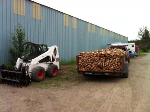

    That mini FEL would be NICE. I kind of hate the Bobcat because it tears the crap out of the ground. I looked at a few but they are hard to find in good used shape. The ones that do come up are nearly the price of the fullsize models.
    I usually carry a couple trees at a time, depending on how big. Usually cut to 20ish ft lengths. Have done treelength but it's tough to handle with the limited room I have.
    As far as what I pick up, I normally cut to 20-30ft and I'll grab 4-5 of them depending on size and straightness... sometimes better to do more trips instead of having a mess to untangle.

    Gotta pic? What are you using?

    Only one I have. Hard to take a photo in action since I'm the operator and camera man. :DGrapple is 84ish" wide I believe. Just barely fits on my trailer.

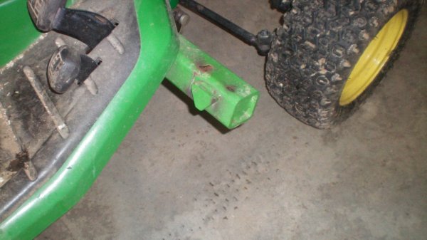

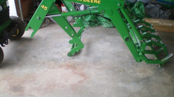

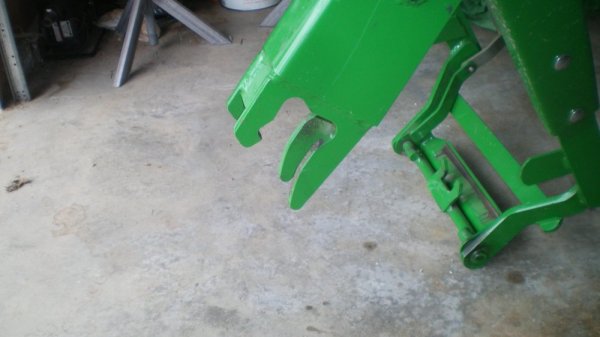

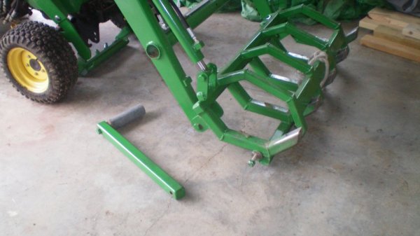

    Made yet another discovery this morning. If you've made a lot of attachment changes on tractors, you'll know why I liked what I found. If you haven't been around much of this stuff, I'm sure I can explain it right into a confusing cluster fugg... :loco: :crazy: OK, getting ready to take the loader off the tractor to put the mower on. For 11 years, since I made the claw, I have pulled all of the hinge pin bolts out, dropped the claw away, put the bucket back on the arms... and then, took the loader off the tractor. With the claw attached, the main arms wouldn't go low enough to allow the main loader attachs to rotate enough to let go of the tractor mounts. Here are a few pics... the odd shaped mounts first.
    I wondered if I took just the support arms off (easy 2 bolts), and tied the upper claw to the main claw, if I could use the tilt rams to swing it up enough to let the whole thing lay the way it had to, to disconnect.
    It worked perfectly.

    I put the claw on the JD this morning. It was awesome being able to now use the tilt rams to "set" the position of the whole claw, so the main 2 support arms could easily be attached. I didn't even get the impact tool out, just used channel locs on the 2 easy 3/4" nuts. This little smilie doesn't even come close to how nice this was... :dancer::dancer::dancer:
