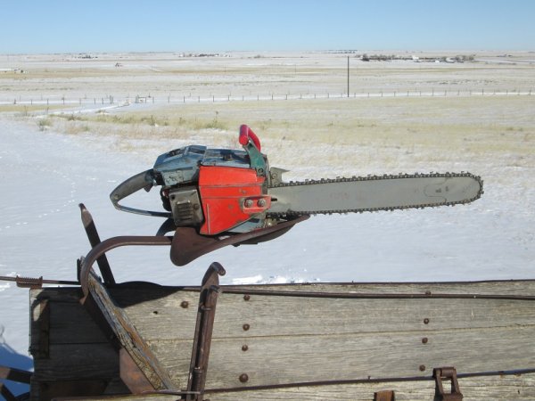

    I have had this saw for awhile and decided to get it going.
    Things I had to do to make usable.
    I think a tree or something fell on this saw at one time because there were a lot of broken pieces.
    No automatic oiler and the manual pump did not work. Found a crack in the housing and replaced the pump with a used one I found on line. Blew out all the oil lines with compressed air and now she works great.
    Rebuilt the Carb.
    Installed new crank seals.
    Put in new Points.
    The hand bar was bent bad and replaced it.
    New fuel lines and filter.
    There are a few more minor things that need to be done like the throttle lock and will get into that later.
    But now the saw runs great and another addition to the collection.

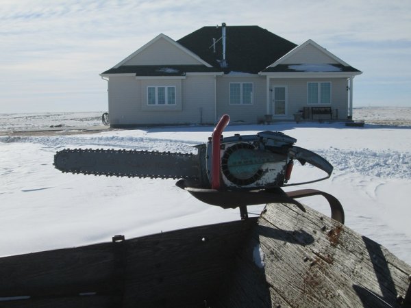

    Looks good, Roger!
    I like the scenery too.

    Sure looks like Wyoming! The saw looks good too!
    Mag Craft likes this.
  5. Mag Craft
    Mag Craft
    Dec 15, 2014
    4,802
    27,736
    South East Wyoming
    I had all the dirt roads plowed and then last night the wind blew like crazy and drifted the snow across the roads again. That's Wyoming, but I do like it here.
