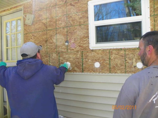

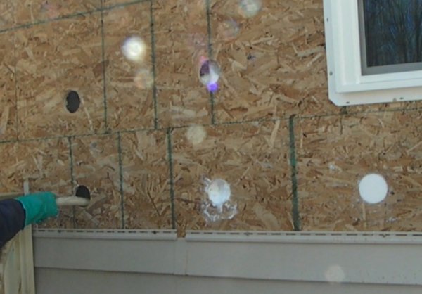

  16. Backwoods Savage
    43,457
    269,000
    Nitrodave before you sign up, you should make a call to John Dennis. 989-845 727 or 989-274-4242.
    For what it's worth, he did a lot of insulation for us and also for Pallet Pete. I've also got him a lot of business a long distance from here. He told me once he goes almost anywhere. He has a large crew if needed and they work fast but do excellent work.
    Perhaps one of the best things about him is that his prices are much, much lower than most.

  17. Pallet Pete
    Pallet Pete Moderator
    13,451
    53,867
    Ovid
    Yup the difference is astounding too. Very good for the price. Our entire house was $3200 if I remember right. Most we called where between 6k and 9k for similar service.
