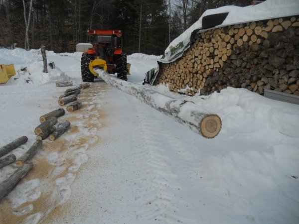

    IIRC they were about/around $3k and complicated the hydraulic side of things, but it has it's own "talents" different from the winch. It's hard to beat a winch for snagging 3-4-5 logs per "hitch", where the grapple requires you to manipulate 2 logs close together to be able to grab both. One use that I find handy is holding a log at waist height to buck into firewood length when processing.

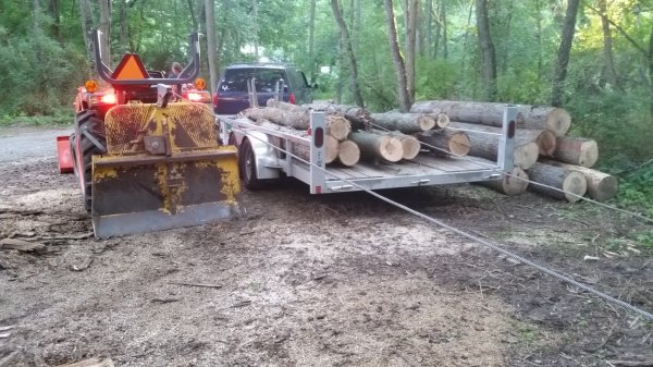

    This one is somewhat fitting as you can see the skidding winch and how I use it to unload logs off the trailer(I get most of my firewood off of my property). I simply park right next to the trailer so I don't have to walk to far to hook/unhook the chains. Double back off a tree directly behind the trailer and pull with the winch. downloadfile-4.jpeg

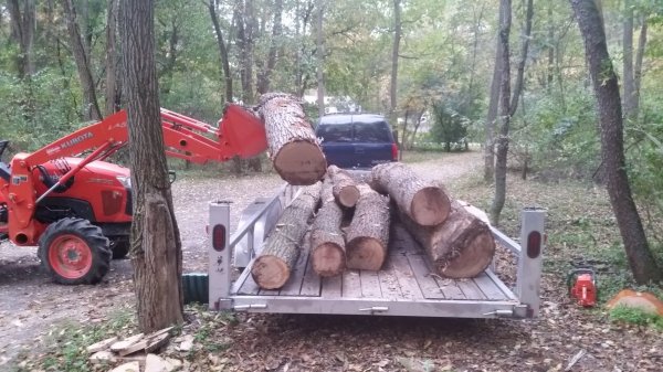

    I will also use my chains and hooks that I welded on the top of the bucket. I will mention that you should be very cautious lifting logs and other items that could slid/roll down the forks much higher than I am in the picture as they could easily kill you. 20161020_181759.jpg

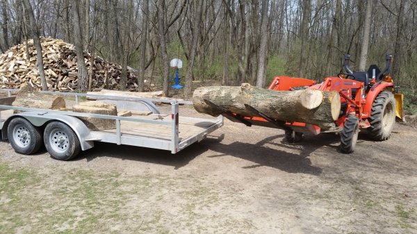

    Then other times I will pull them off the back far enough to get to the center of balance of the logs and then get them with screw on forks. I'd really like a nice set of pallet forks so I don't loose so much lifting capacity, but we make what we have work till we get something better :). This log is a perfect example why I could use the pallet forks as the only way I could lift this was cheating it up, and I believe it would have lifted it right up if it was a bit closer to the pins and didn't have the full weight of the bucket. 1461172605865.jpg
