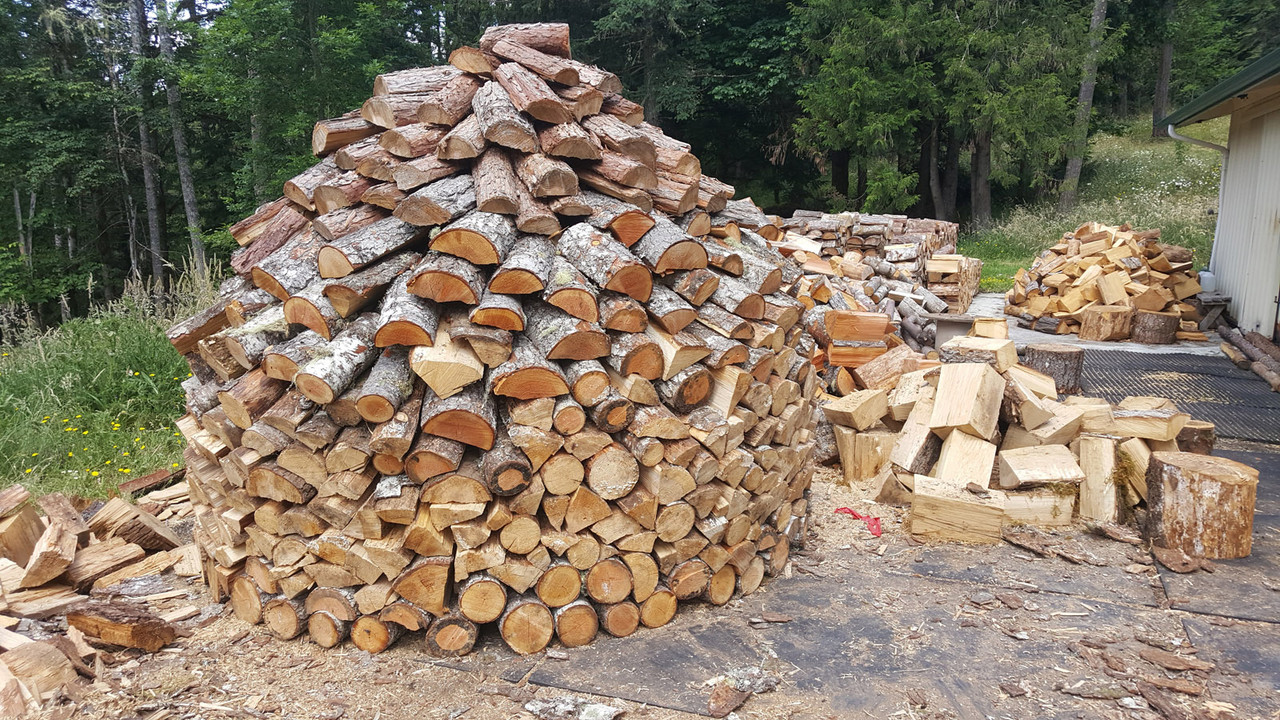

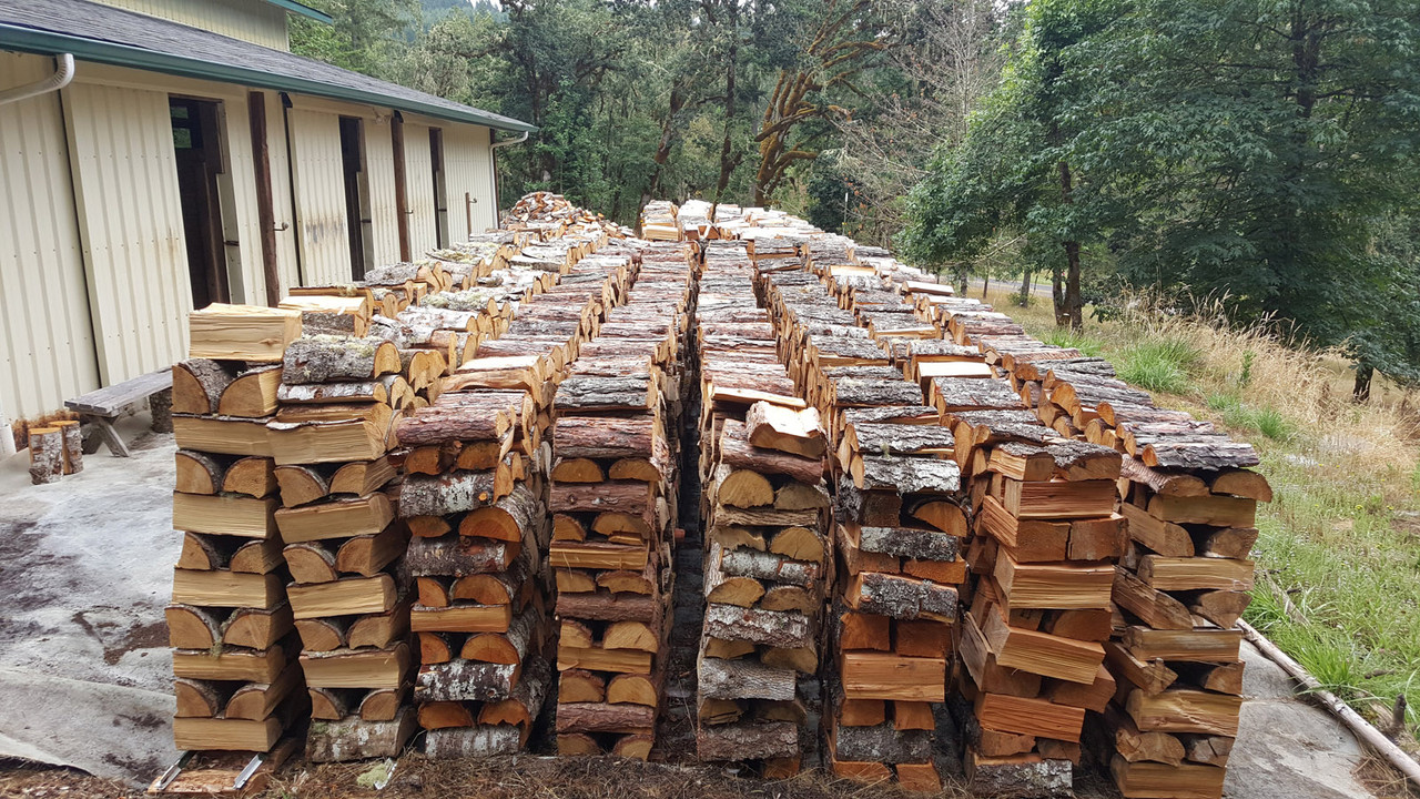

    I built one. Didn't enjoy it in any way - wasn't for me. Would much rather have wide space between my stacks like I have in the picture below.
