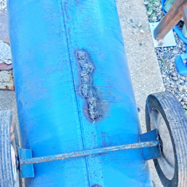

    So, the video in the original post is interesting. Around 2:45 we get a better view inside the tank. There is at least a handful of loose rust still present in receiver tank on the left side.
    There is a follow up video where the owner says the compressor is 10 years old at the time of failure. He drained it regularly and the relief valve worked. The follow up video speculates the failure started at the seam weld that was at the bottom of the tank. I would agree with that. The owner says he had no indication of a weak tank, but I believe he did....he rewelded the factory bung the drain valve is threaded into. In the video part of the bung is factory paint and part is rusty weld.
    I think the tank failed along the seam but original failure was where the wheel brace was welded to the tank body. Then the crack propagated along the HAZ of the weld. Then butterflied as the air put a twisting motion on the newly freed side of the tank. The fact some of the welds were rewelded leads me to believe the welds were of poor quality, poor penetration, porous, bad heat management..... And possibly crappy steel.
    I've seen some pretty bad Chinese steel in the last 10 years. I've seen some pictures where some bad welds were hidden under caulk that was applied to look like weld beads before painting.
    And it all looks good with a shiney coat of paint

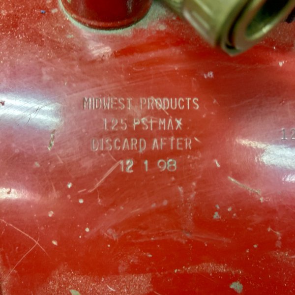

    Nice catch....and I wonder how many pig tanks at work and the farm are out of date. I do know we have some that have been on the farm for 40 years.

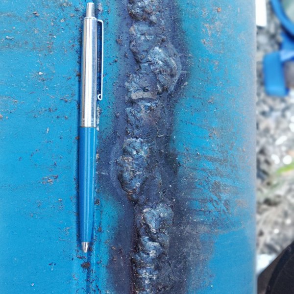

    This was brought to me today to see what could be done with it.
    I said scrap it!!
    He left it, has nice wheels on it though.
