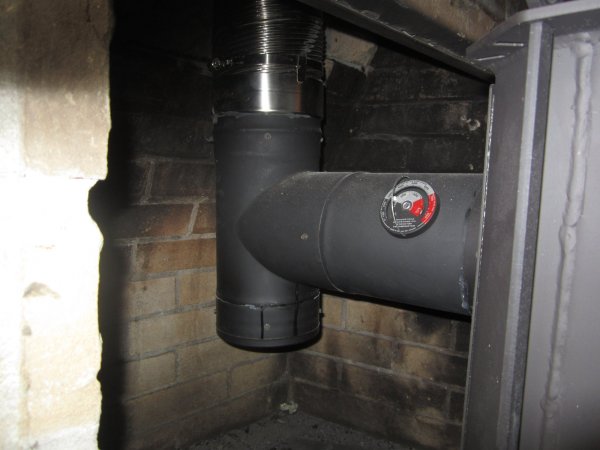

    So I went ahead and got an Auber Instruments alarm with a flue temp probe. Is there any place specific that it should be mounted. I would love to take out a screw in a connection and use that instead of drilling more holes. I have a picture with my set up. I was thinking of putting it at the top of the tee where it connects to the SS coupling. Somewhere here I read something about 18" above the tee. Not only can I not get up there, but I would hate to drill holes in the SS liner. The coupling and the T are much thicker and would hold a screw better. Thoughts? IMG_6195.JPG IMG_5929.JPG

    Looks like a good spot to me.
    What is that stove?

    18 inches is a general rule for above your stove top, In that setup I think 18 inches above the tee would actually be too far.
    I think the spot you were talking about would be just fine.
    Mine is single wall pipe and holds the screws just fine.
    You still have to drill some holes you need 3 holes
    Don't forget to take it out when you clean your pipes, :whistle::headbang:
    That's going to be a lot better than looking behind there at the magnet mount

    Not yet. I wanted to make sure I'm mounting it in the right place. Don't feel like plugging holes. So I think I'll mount it up as far as I can without getting into the liner. I guess the 18" rule is so that ambient stove heat doesn't skew the readings?

    The part I like is the alarm to alert in case we forget to close the draft up after establishing a fire upon reloading.

    Yeah I hit 900 on the pipe 2-3 times , alarm saved me :)
    Is your pipe single wall ? Looks like it

    Yea, single wall.
