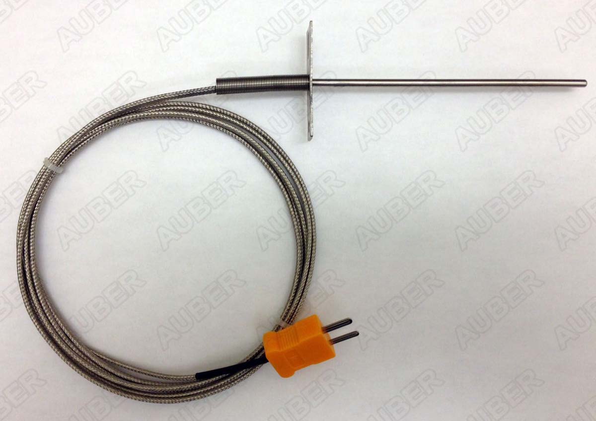

    Pipe probe ,fore double wall or single wall
    Washer sensor
    Magnet Probe for Stove Top Surface
    Well Seasoned and Todd like this.

    Thanks for the pictures. I'm getting ready to order AT100. I was planning to get the washer style mount.

    I got this order in the other day, one probe sensor for the pipe installed just below the damper and one washer sensor for the stovetop. I run a blower all the time so I put the washer sensor under a small piece of ceramic so the airflow over it would affect the reading less. The stove top sensor is reading about 75-100 degrees lower than my IR thermometer. The probe sensor is reading about twice what the IR thermometer is reading on the outside of the pipe.
    Both of the slave units communicate with the master upstairs, you just have to select a different ID for each slave. And then in order to see the reading from either slave you just tell the master which ID to display, nice to not have to run up and down the cellar stairs a bunch of times.
