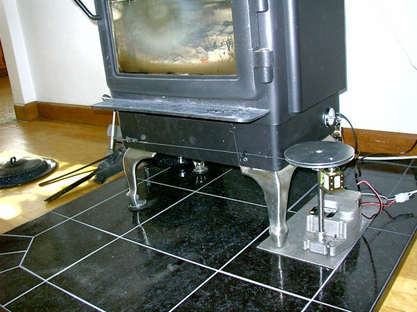

    This is my automatic air controller, it uses a temp controller and timer to actuate a HVAC damper actuator.
    It works quite well but is somewhat limited as to what it can do, it will only close the air control based on flue temp.
    When the flue temp reaches 875* the temp controller (on right) and timer will turn on the damper actuator for 4 sec, this will close the air control about 1/2 in. It will then wait for 20 sec, and if the temp is still over 875* it will close the air another 1/2 in, the cycle will continue until the temp is under 875*
    Also the stove top controller( on left) will turn on the blower when the stove top temp reaches 675*
    Here are some pics and a vid.

  5. HDRock
    17,268
    60,522
    Now that's cool :cool::thumbs:
