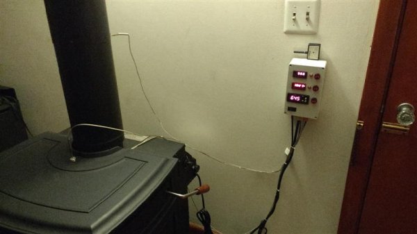

    Have not posted in a while, so here is a little update:
    Retired the Regency F1100, and purchased a new BK Ashford 20, really like it.
    For the new BK I decided to make a new updated temp controller /alarm.
    This one has three controllers, Flue, cat and stove top. The controllers all have alarms, and the stove top
    controller also turns on the blower at 675*.
    The flue alarm is stet to 875* and doesn't usually go off that much. It definitely will let you know if forget and leave the door open :emb:
    The cat alarm is set to 365* the temp where the cat is active and you need to close the damper. (Also good if you become distracted and forget)
    The stove top is set to 775* and has a TC bonded to the steel top under the cast iron jacket.
    I really like having the monitor/ alarm, you can easily see what the stove is doing, and helps prevent over-firing.

    Nice set up
