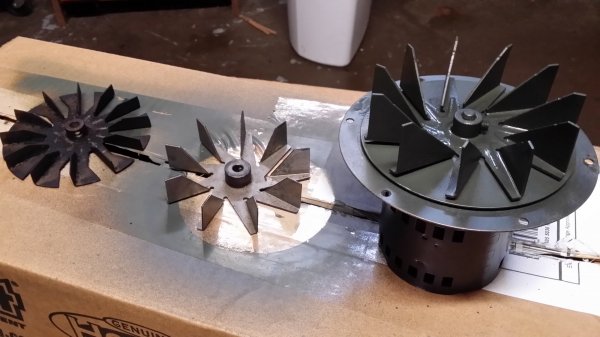

    As for the impeller? I bought a large impeller from Don2222 last year for my furnace. With the new motor, impeller, manifold (exclusive to that furnace), and the burn pot mods, I doubled the amount of air through my pot. It's a very clean, hot, and efficient burn
    My OEM impeller is on the left. The middle impeller in the middle is an OEM unit from my Quad CB 1200, and the one on the right is the new/large impeller from Don.
