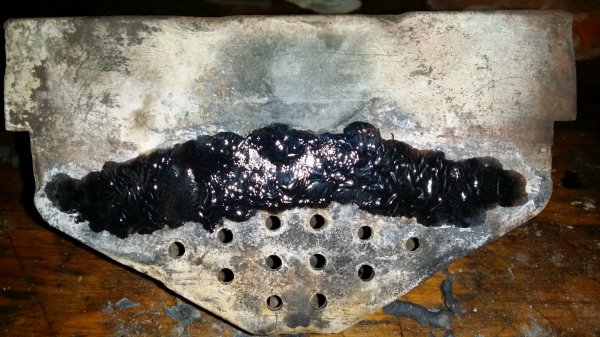

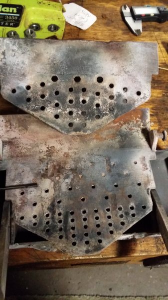

    What does the burn pot or liner look like? Can you plug some of the holes up higher in the pot?
    Air above the pellets won't help combustion. If you can close up some of the upper holes (high temp 3M foil) or stove/furnace cement will work well. I did this to my Fahrenheit Endurance 50F pellet furnace.
    The pot on the furnace is square, but you can see how I closed off some to back of the pot with furnace cement. It holds for years.

    It seems like a lot... But...
    If you look at the 1st pic, there is 2 different pieces. The front and back (top of pic) of the pot. The final pic is just the back. I only covered 2 rows of holes in that part of the pot. The other part in the first pic has 50+ holes. The furnace pot has 4 pieces. The back, the front, and the bottom 2 liners. Between the 4 pieces there is probably 200 + holes. So to cover 40 of them, isn't much at all.
    Now if your pot only has 20 holes, then covering 4 will give about the same return (20%).
    Hope this helps.

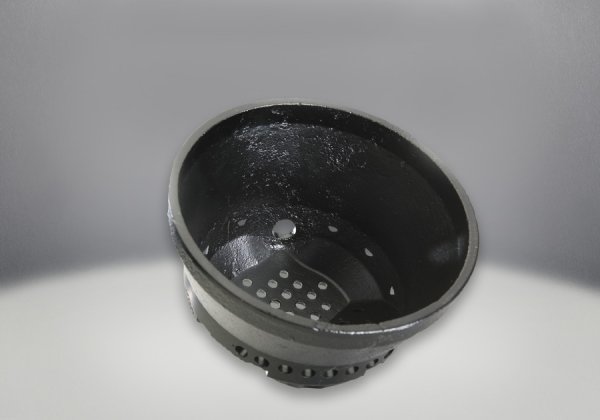

    Here's a picture of the burn pot from the manufacturer's website..
