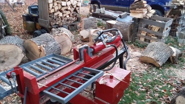

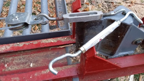

    Well, I found the limit of my log lifter today...or at least part of the linkage...this turnbuckle darn near straightened out enough to pop off! I couldn't figure out why the lift wouldn't come up enough to pin it in "table" mode...but it became apparent on the next log when I went to hook the cable back into the wedge and the turnbuckle fell off the pulley! That was an eye hook previously!
    I'll bend it back and tack a lil weld on there as I feel like this one is overall stronger than the one I put on just to finish the day out. IMG_20241102_182059699.jpg
    Splitting up a big ole eab killed ash tree from work...the round that tried to kill my lift was headed toward 30" diameter.

    I weld eye bolts and things like that because they straighten out pretty easy. I used eye screws in my walk in cooler and they would straighten with me hanging and lightly bouncing on the rods. A nice weld took care of that.

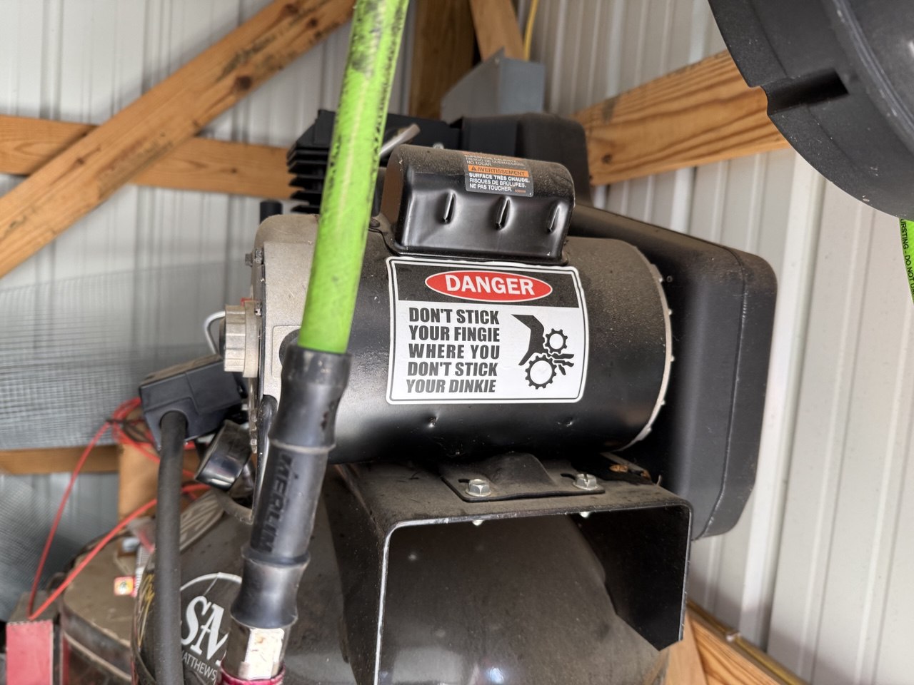

    Also:
    Lol. I have this sticker on my compressor:
  11. Canadian border VT
    19,816
    132,163
    That Australian red gum is tough wood; termites can’t eat it..
