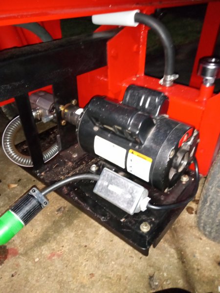

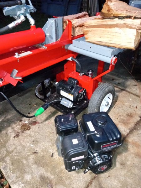

    Well, I was able to make the inaugural run of the "electron to firewood converter" today...and...it works! :dancer:
    Had to lower the system relief pressure a couple hundred pounds more (22-2300 PSI now) which I don't understand, because this "5 HP" electric motor is rated at 15 FLA, which at 240V single phase that should be slightly over 4 HP...and even if the pump was set to shift to high pressure/low flow mode at 900PSI, that's only 2.2 HP worth of work according to my calculations...and I even had the shift point pressure backed clear off (about 400 PSI, or less) and the motor would still stall out if the system pressure went over that 22-2300 PSI area...so that makes no sense to me, at that pressure it should take less than 1 HP to keep things turning.
    I pulled the shift valve out and looked at it...it looks perfect, as it should be, being a basically brand new pump, so doesn't appear to be an issue there. It's kinda hard to catch a pump shift lo to hi without having a super nasty log, (like some green Elm) which I do not right now.
    But bottom line is that it will work fine as is...I split some of the knottiest stuff that I had here and never seen anything over 500 PSI on the gauge...but I still would like to get to the bottom of why I can stall the motor out at 2500PSI.
    The Predator 301cc engine was still mounted to the splitter when I pulled it out of the shed, so I popped it off, and bolted the electric motor on...only took a couple minutes, as I had hoped. All in all, I'm pretty happy with how things turned out.

  11. Jeffrey Svoboda
    Jeffrey Svoboda
    2,915
    17,215
    That's pretty sweet! Good luck sleeping tonight with that whole motor stalling at 2500 psi thing. :rofl: :lol:

    I wish i knew more about hydraulics where i could help you talk it thru. First thing to my mind is what's your voltage at the plug?
  13. brenndatomu
    25,340
    165,012
    Slept like a baby :)
    I haven't had time to troubleshoot much yet, so I'm not stressing about it...first thing is going to be to check volts/amps, and the run capacitor...then I want to take that shift valve out again to check it, including the pressure sensing pin this time...

    Pretty cool that the swap is relatively quick. I'd love to have an alternative to my loud gas motor.
  16. brenndatomu
    25,340
    165,012
    I think I am going to try to make a foam box to cover the pump...thinking that may take a lot of the pump whine away...if that works then it will be pretty darn quiet!
