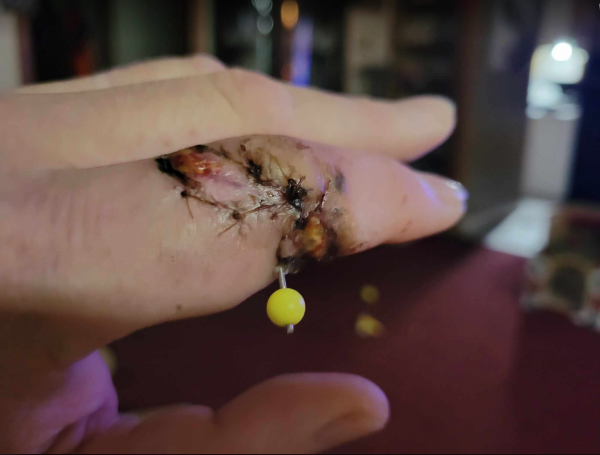

    Just don't do this!
    A buddy just sent me this. This is 2 weeks post surgery. He got his finger in the way of a splitter helping a buddy split wood.
    That is a pin holding the bones together to heal. It will be removed once healed.
    When it first happened he captioned these photos with, "apparently I'm not as good with this whole wood splitting thing as you are". LOL He said the finger was just hanging.

    Wow! :bug:
    That's just, uh...not good! Well, it's good that they were able patch/pin him back together though!
    That's the only thing that gives me any pause about building a fast splitter, is the greater chance of injury (maybe?) heck, I've had a close call or two with "slow" ones! :picard:​
