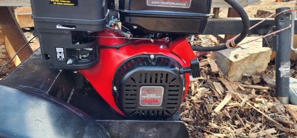

    More power.jpg I recommend MORE POWER!

    I can't remember, were you upsizing the pump too?

    No, just didn't like the air filter set-up on the display 11HP motor. Boxed ones may have been different, but for the $50.00 or so difference I felt like it was worth it. Also had a 20% off coupon. I have thought about it, and some said that I should, but didn't want to go down the rabbit hole as you know what happens then. Bigger hoses, better cylinder and valve, the list goes on. I use the 30-ton anyway and Edwin doesn't mind how slow it is.
