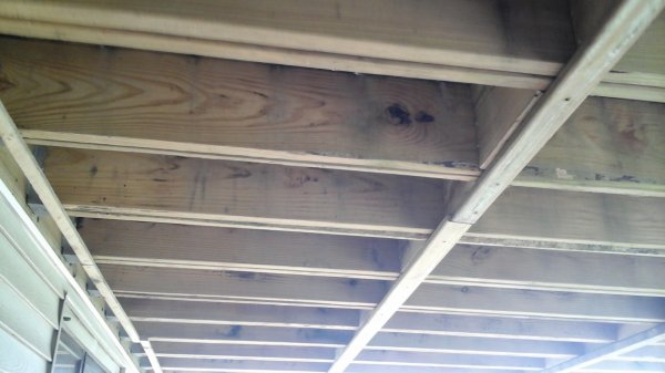

    I don't know I go for the over kill theory my deck holds 12 cord. 2 by 10 doubled 16 oc joist hangered are with 2 by 12 tripled at half way point to carry weight. here's a pic of joist above deck... 20150711_141733.jpg
    That's 16 feet high engineered to hold 7000 lbs live weight whirl pool.. the strapping you see if to pit pitch on plastic roofing so so it shedS water..
