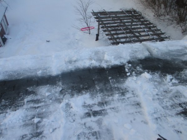

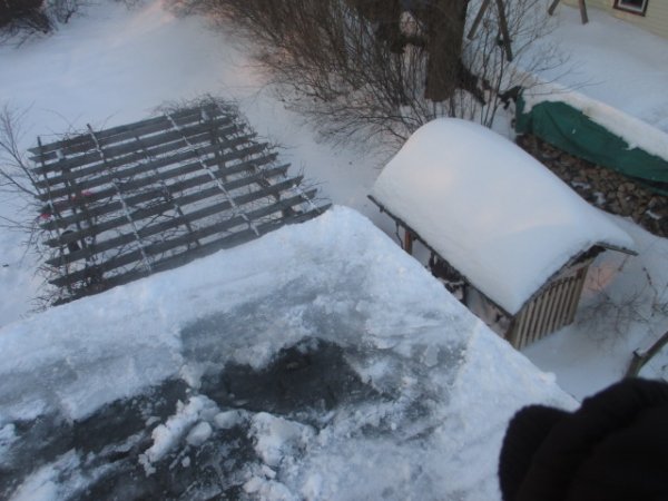

    Ended the afternoon on the roof. I have an ice dam across the back of the house about 4" thick at the edge. There is about 2" of standing water behind it. I have no leaks as this area was a renovation project a few years ago and I put ice & water shield over the new roof decking. I chipped some channels halfway through the ice and will get some Calc. Chlor. on it tomorrow.
    I have overhangs on my roof like a cottage style design. Snow and ice melts on the roof and these overhangs are freezing the melt off at the gutter. I have a bath vent that goes out between the rafter tails at the overhang. I believe the heat leaving the vent is causing the melt in the area.

    I was at HD last weekend and the have a FLIR camera for locating heat losses this time of year. It was somewhere around $80.00 for 24 hours. I am probably going to rent it and see what is going on here.
