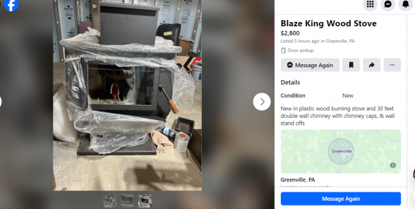

    Not sure on the model, but this is a "smokin" deal on a BK/chimney for someone!
    Pyromaniac, Chvymn99 and wildwest like this.
