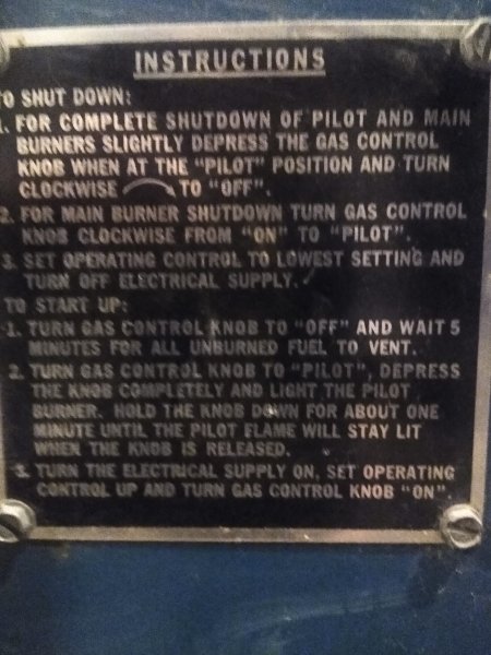

    I may have made an amateur mistake about a month ago. I shut the gas line off to the boiler when doing some other work, but didn't shut the switch to the off position on the boiler. I figured I'd just turn the gas back on when it got cold.
    Well, the cold is here. I tried to turn the boiler switch to the off position, and then relight the pilot. The switch won't budge from the on position. I've tried depressing the switch, no dice. I turned the gas back on from the line valve, left it for a couple of minutes, then tried again. Still no dice.
    I'm in big trouble if I don't get the boiler going again. Any tips would be helpful before I resort to spending the big bucks on a plumber. [​IMG]

    Update- I was able to get the switch turned from on to pilot. So I depressed the switch for a minute per the instructions (after turning on gas main), and nothing. Still won't turn to the off position.

    I called the plumber, he was in the neighborhood, and just finished another call. In the 20 minutes it took him to get here, I was able to get the switch to the off position. Lots of wiggling and I don't even know what, but it finally turned. I waited the 5 minutes per the instructions, and turned it back to pilot. No flame.
    The plumber came downstairs, looked it over, turned it to pilot, reached way under with a lighter (not where I was trying to light it) lit the pilot. You have to use a flame, unlike the water heater, and have to get on your belly to see it.
    He then turned it to on, I went upstairs to turn the thermostat up, and didn't hear the sound. Remembered the electric switch was still off. Turned it on, and whoosh.
    So, my inexperience was the cause.
    The plumber is a really good guy, gave me a couple tutorials on how to fix the thermocouple (apparently the most common cause of failure), replacing the sacrificial anode in the water heater (which I just replaced in warranty about a month ago), and gave me a couple of other good ideas.
    All in, a $69 set of lessons, well worth it. And the pipes won't freeze.
    Thanks all. I don't think hammers and wrenches would have been a good idea on that switch. :faint:
