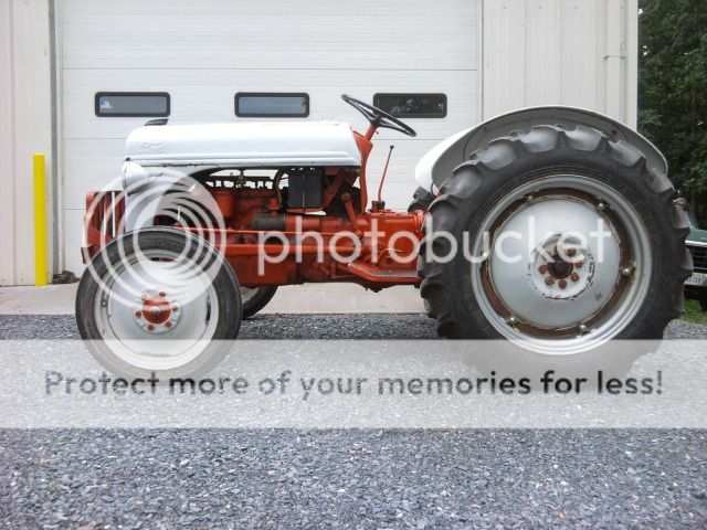

    Thanks for the thoughts everyone, I think I'm going to talk it over with him in person, if I can get him down on price, at all, like even a hundred bucks, I'm going for it, I think the general consensus is to go for it, I know I'll find more uses for it once I have it here. New tires all around, chains in really good shape back blade new battery and new brakes, there's well over a grand in value there. Yes I'll be using it but after 2-5 years in my hands those tires will still have 90 percent of the tread on them. It won't have a lot of abuse here. Also, yes the wife is okay with whatever I decide, so there's a plus!! Hopefully in a matter of a couple weeks I'll be posting pictures!

    I think $2500 is on the upper end of what that tractor is worth. The blade is too big for it, it looks like a 7'. It is also a light duty blade that tractor will tear up. I'd tell him keep the blade and knock some off the price. I did notice it has a draw bar on it, and it also has the stabilzers on the 3 point hitch which is a plus and a front bumper. It also has the cyclone pre cleaner on the air filter. I think the rear tires are too big on it. It should have 10-28 tires on the rear. Too large of tires will mess up the gearing. Low gear will be too fast when you need it to go slow and reverse will be way too fast. After looking at the chains I think they are set someone made, possibly off a large tractor since the links are so big. That does not hurt anything. I noticed that some of the crosslinks are 2 links apart and others llok to be over 4. So I would count the chains as nothing. Check the oil in the differential, it is also the oil in the hydraulic system. It is pretty common for water to get in the oil. Check out the hyrdaulics on it and see how well it picks up the blade then maybe even leave it up and shut the tractor off and see if it leaks down quickly.
    Also the 8Ns do not have live hydrulics so when the clutch is pressed you can't raise the 3 point. Then they don't have a live PTO so when the clutch is pressed the PTO stops. Like MM said you need to get an overrruning clutch on the PTO.
    I think the tractor, if it is good condition is worth $2,000 tops. 8Ns are not bringing what they once did and are actually a little tough to sell. The subcompact tractors really hurt the value of the 8N. I would try to find a newer tractor like a 640 series if your budget permits.
    I'm not trying to knock what could be your future tractor. I'm just trying to point out anything I can see and hopefully you can use it as a bargaining tool. Good luck with the deal.

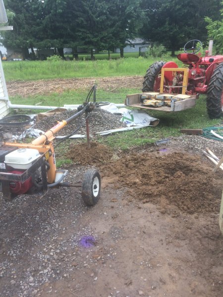

    The tractor supply 3pt angle iron forks I bought for just over $100 a half sheet of 3/4 plywood and some 2x sides use it all the time! Have had so much on it (big rocks) had to steer with the brakes had the front tires a foot off the ground haven't bent it yet IMG_0833.JPG

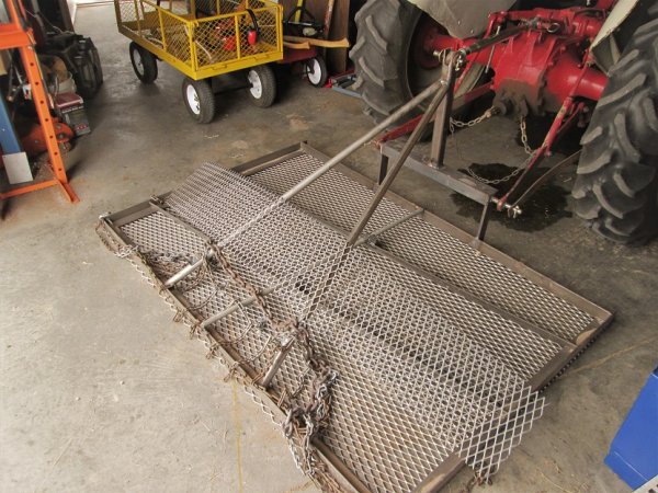

    I have a 48 8n that I use all the time. I maintain a dirt road that is about 1/3 mile with it. I also have a brush hog for it and it does ok. You are a welder so you can make things for it also.
    I have a drag that I use on my road for knocking down the wash board that I made myself and fits on to the 3 point.

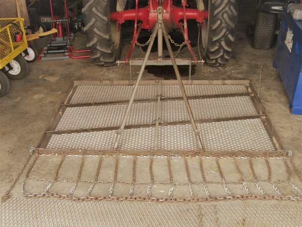

    Here is a picture of the drag I made for helping to remove wash board on my dirt road. That mesh on the bottom is what you find on trailers for walking on or sometimes they use it on a ramp.
    The idea is to spread out all that loose stuff on top that ends up wash boarding. If I have to scrap the road or contour it then I use a blade.
