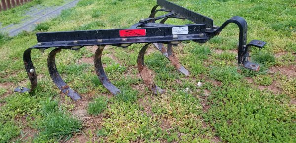

    I have the one in the picture below and am clueless on the right way to setthe thing up. Any help is appreciated. Thanks.

    I'm only used to my 3 point 1 row cultivator but i would think set up should be similar. are you planning on using it for doing weeds between your rows? If so your rows have to be set up to accommadate the width of your tractor wheels. the two inner most tines need to be set wide enough that you don't uproot your crop OR cover it with dirt. slower is better most of the time. pics of your set will help.

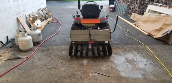

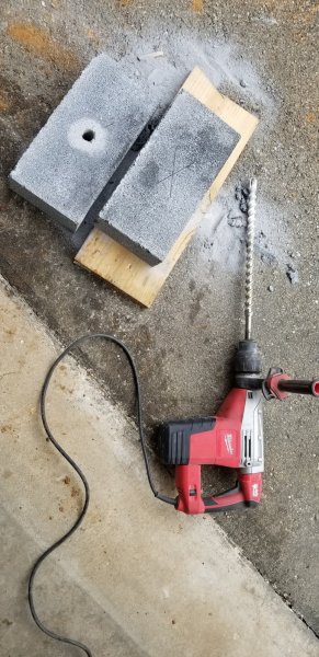

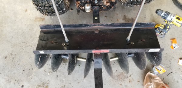

    i made some mods to my disc.... not bouncy around anymore.... at all

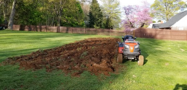

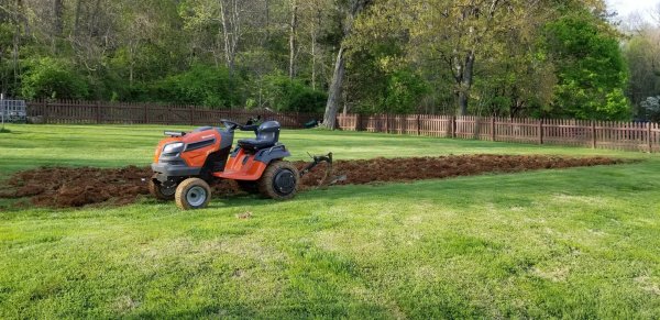

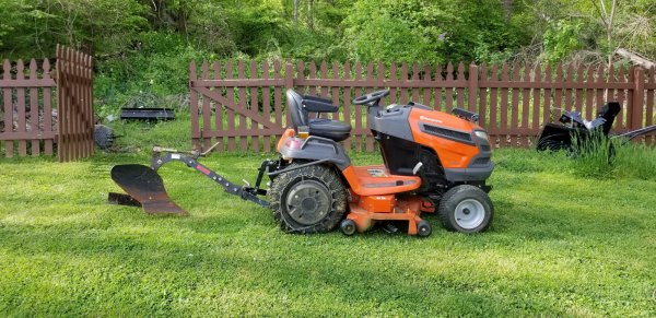

    and some moldboard glamour shots.....

    As Farmer Steve said, you'll be removing tines to fit your row width. Uniform rows are much easier to deal with.
