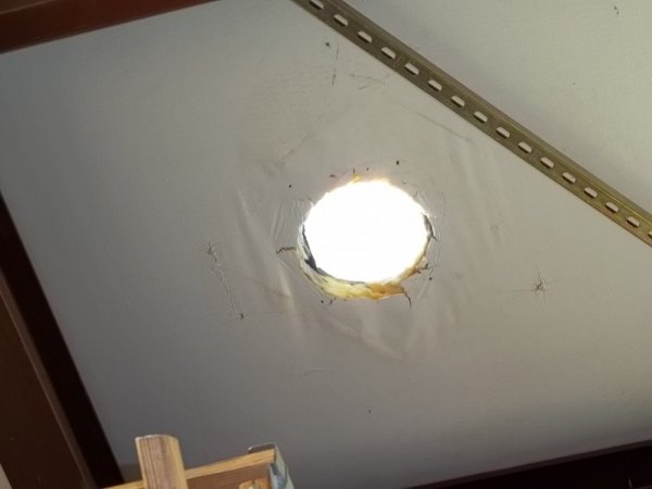

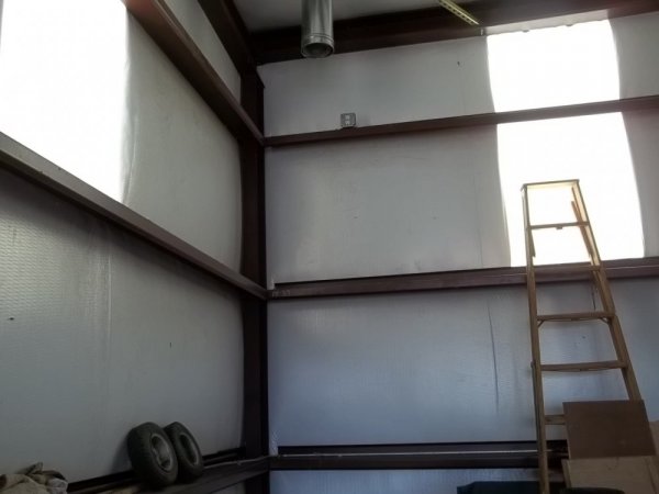

    Some progress today, I removed and capped off the NG line (it's closed at the main also) from inside the shop. Removed the hanging furnace and did some lite dusting. Not sure what I'm going to use for the surround.

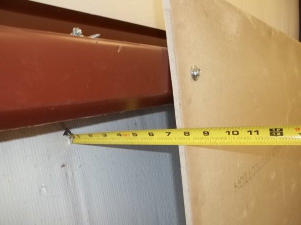

    Question;
    If I frame the corner with plywood and durarock (sides open) and then use a metal surround for an air gap, will this be enough to protect the wall insulation?

    I wouldn't use plywood, it's another combustable that would be closer to the stove than the insulation. I would just use a metal shield.
    How close to the insulation be to the corners of the stove?

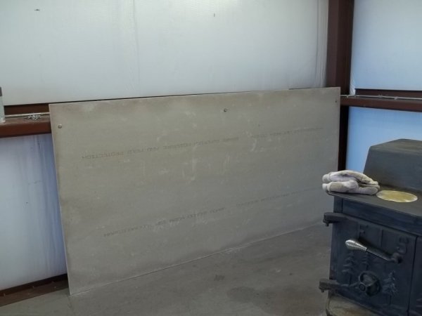

    Update today, I attached two 4'x8' sheets on Hardie board to the purlins and filled the corner gap. I might need to rethink my setup because I didn't anchor the bottom of the sheets, I'd need to fab a long spacer for this. I haven't decided what to use for the second gapped wall yet.
    WeldrDave and fox9988 like this.
  10. papadave
    Unicorn1, you've already got your air gap. It's behind the Hardieboard. Hook it up.
    Are you planning to put some more insulation or anything behind the Hardie?
    You can put up the rest above that after the stove is installed.

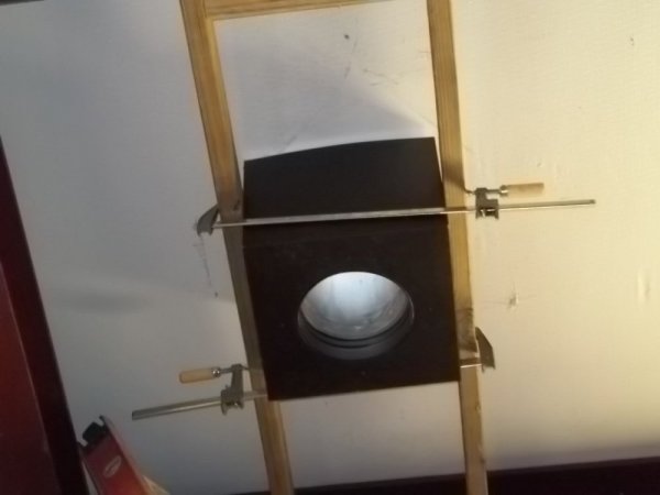

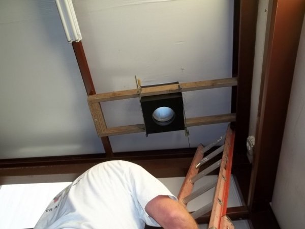

    Another question, do I need to frame in a ceiling support box?
    papadave likes this.
  17. papadave
    I would. It'll support (hence the name) the Class A.
    Follow CTC's and you're gooder to go.

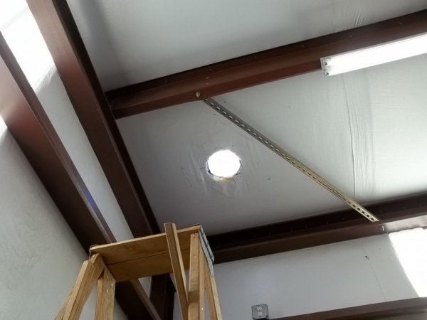

    Today's progress, I rented a 20ft ladder and a friend came out to help. I still need to tweak the support box before final assembly.

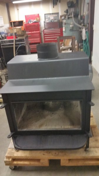

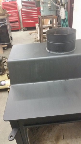

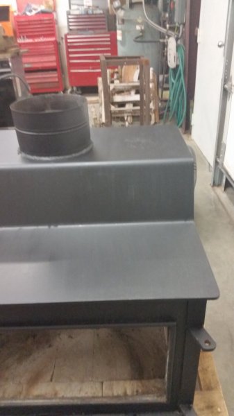

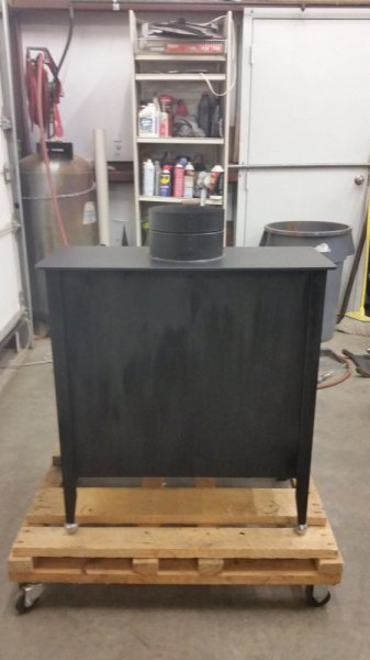

    I sourced the Metal roof flashing from Mueller's Buildings today, sanded down and repaint the fisher stove (paint is still drying). I had to grind down a weld on the door pins to remove the two doors and they will go into the blast cabinet.
