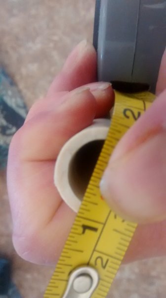

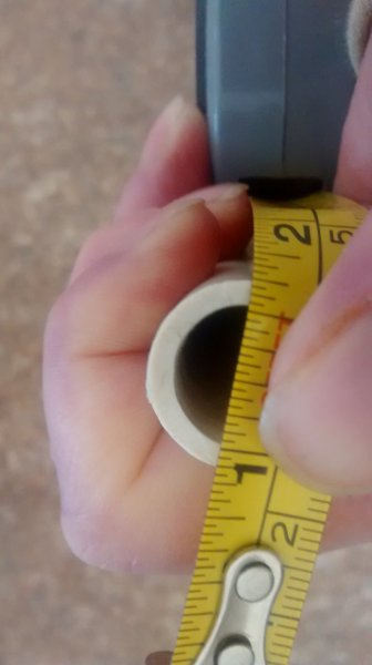

    This the fresh water line to the toilet, is there such thing as a rigid rubber hose?
    OD 3/4" ?
    ID 1/2" ?

    Is it not just standard PEX pipe?

    Thanks! He said the PEX here was rigid and did not fit on inlet valve elbow. I cut a few feet of surgical tubing off one of my aquarium hoses I just showed him with a few passes of heat from a match that the new end of AQ hose easily went back on the AQ valve:rolleyes:. He is skeptical but I think it should work.

    Sounds like it should work but you may might want to add a couple of gear clamps for insurance.
