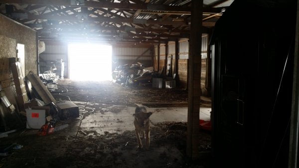

    Yeah I plan on being seasons ahead on wood. This is my setup. Wood in barn south end of barn (roughly 30x60 feet) to the ceiling with truck path left open down center lane after it seasons first summer outside. I will probably buy split seasoned this summer to add to what I am cutting myself. I know it's best left in the sun and wind but if I put the seasoned dry stuff in the barn right away and then have an outside pile I move in to the barn before winter. It will be nice doing all the loading and unloading out of the wind and snow. All that junk in the corner is going to the dump.
