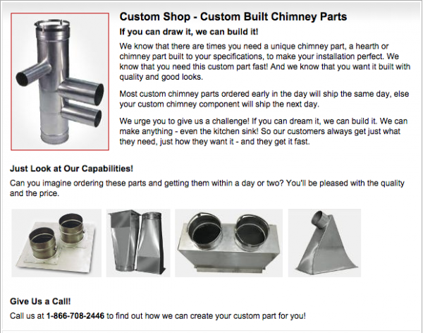

    I am thinking bout makin an adapter....basically a box that will slide over the rectangle exhaust and cut a hole that is round and go up with stove pipe. What size do you suggest 6 or8"?

    Ok, that gives us much more to go on. For the application you describe this stove should serve just fine. Start searching Craigslist http://zoomthelist.com for used 8" Class A chimney pipe. It's amazing how often you see Class A flue systems torn down and offered for sale after just a few years of use. Buy all the same brand and model because different brands are not interchangeable and different models within the same brand may not be compatible either.

    My neighbor has a stove that has a rectangle takeoff to round adapter. I think the stove was there when he bought the place so not sure if he would know where it came from. Generally speaking if it's made that way I'm sure someone makes an adapter. Good luck.
