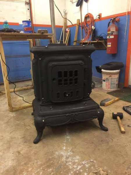

    Update: Washington parlor stove re-assembled.
    Well, it took me the better part of the day today, but I finally got her put back together. It was touch and go for a while, with a lot of muttering and cussing, but in the end, me and my tools prevailed. The problem was that the pieces simply were not fitting together. It would seem that this is one easy stove to dismantle and then put back together, but let me tell you- nothing is ever as it seems when restoring anything. The trick that I happened upon (or, more correctly, the mistake that I was making) concerned the tightening of the bolt nuts. One cannot simply tighten each one as the pieces are assembled. The stove needs to be nearly completely assembled with the bolts loose, and then all of the bolts are tightened at the same time, using a heavy rubber mallet to encourage the mating of the pieces. Until I realized this, I was quite frustrated. I must admit that I got pretty nervous for a moment there, wondering if three weeks of work might go down the drain. And the workmanship of the Taiwanese who cast the sections could have been just a tad better. They had the original American molds for this stove, but they were not good about grinding any flash, etc. So I had to employ the angle grinder and even the Dremel grinder here and there. But in the end, it worked out fine. You may notice that, contrary to my previously expressed plan, I did not do the stove paste finish. I went with paint. I decided against the stove paste when my research on it indicated that it needs to be reapplied every month or so, that it stains anything that comes into contact with it, and a few other characteristics that did not please me. At the moment the stove is painted with Rustoleum flat black 1200 f. But I will be topcoating it with Rustoleum Satin Black High Heat 2000 f. That will give it a little sheen, which I am looking for. Finally, the accent pieces have to go out for plating. While I felt that they came out of the vinegar bath looking great, further viewing established that they were, in fact, not perfect. And when I went to clean them with steel wool, a lot of the plating flaked off, revealing rust damage underneath. So I figure since the stove came out so nicely, and I am rather happy with it, I will be a sport and spend some money on re-plating the accent pieces. If I cannot find a plater within reasonable driving distance, I will refinish the accent pieces with Lab Metal High Temp bondo. Now I have to put the window in, finish the handles, find an adapter for the oval shaped exit port, buy stove pipe, and chimney parts, and get this baby into place in the house.

    That's gotta feel good getting all those re-finished parts bolted up again. Nice job Alden ... :yes:

    Lookin gooder now :thumbs:

    That's an improvement to say the least and you likely know your stove a lot better now in case it needs repairs or you're aware of a weak spot.
    Really good job!
