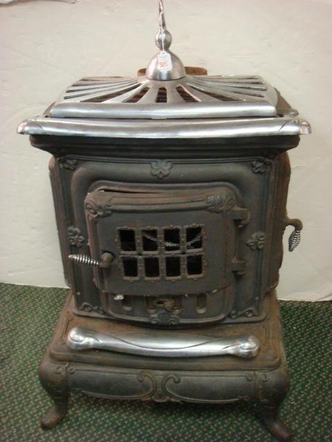

    Hello to all. My name is Alden and I am new to the forum. I am an early retiree from NYC now raising sheep, chickens, and bees on a small farm in Linneus, Me. I recently acquired an old, rusted out wood stove which I am refinishing and planning to use to heat my house. The stove, as far as I can tell, is made in Taiwan and was marketed as a 'parlor' stove in the US back around the '70s. There are several versions of the replica, the differences basically being more or fewer nickeled parts. I have read that the design is intended to replicate a stove popular in the 1880s. I have also found the stove referred to as a "Washington Stove." Below is a photo of the stove that I found online.
    My own stove (photo below) at the moment, is laid out on my garage floor, where I have dismantled it to its component parts for refinishing. (I went through hell and highwater to take her apart. The stove is made up of several sections and various parts that are bolted together. My stove was so badly rusted that it took me nearly six hours and a pile of tools to finally break her down.) I looked like a chimney sweep at the end of the day -just from the dismantling!
    The good news is that the clean-up seems to be going well. In the photo below, the firewood grate and the top plate section can be seen. So far, I have de-rusted the top plate, which on my version was not nickel plated. I am pleased with the results so far, though de-rusting just that one piece took a few hours. It will now go into a vinegar bath. I am almost finished de-rusting the grate. [My de-rusting procedure consists of wire-wheeling the flaky rust, then a vinegar bath for a few days, a then a soapy wash, then applications of Must-for-Rust, then paint.]
    /// I do have a few issues that I hope to resolve with advice from this forum. The first issue is that my stove is missing the 'smoke plate' that should be hanging down, just inside the right side door. (The stove can be loaded from the front side, right side, or top side.) My understanding of a smoke plate is that it permits loading the stove from the side doorway without smoke exiting the stove into the room. This stove is supposed to have a smoke plate that hangs down about half-way from the top. That is, when you open the right side door, the smoke plate is hanging there and it swivels up and inside so that one can insert pieces of firewood. I am wondering whether and how I should replace the smoke plate.
    /// My second issue concerns the nickel plated parts. On my stove, the decorative parts that you can see in the topmost photo, one of which sits on the stove's top plate, and the other of which sits on the base section, are badly rusted and pitted. I do not relish the thought of spending major bucks on replating. So paint seems to be the best option. I do not know whether the plating is actual nickel -I am only assuming it is. I feel pretty sure it is not chrome. But I have to decide how to make it look nice.
    /// The final issue -and most important to me, concerns the fact that the stove lacks any baffle inside. The stovepipe portal, if you can see it in the photo, is a top exit, at the center rear. It seems to me that a woodstove should have a steel plate that sits a couple inches below the exit so that the heat from the fire does not go directly out and up the flue. I want to add in a baffle, but I cannot find online any engineering specs for such a mod, though the design aspect seems simple enough. And it seems that an added-in baffle will foreclose any possibility of adding in a smoke plate due to space constraints. It was also my intention to line the inside with refractory bricks. I am thinking about having a baffle plate simply sit on refractory bricks that are set up on each side. /// I would be grateful for any comments and advice that I can receive from the forum. Thank you.

    Hi Alden and welcome to the forums. I can't offer too much but I have a few questions. That's great that you are restoring the stove. I was not aware reproduction parlor stoves were made overseas. Are there any castings with name or numbers anywhere? Please post pictures as you go as it may become recognizable by someone out there doing an internet search for this type of stove.
    Was there any refractory cement where the plates meet up? As far as paint, I would go with stove paint or stove black paste.
    As far as the smoke plate can a new one be welded/fabbed up to fit? I hope others can help out here. If there are any names, post them up and maybe it will generate a search hit.

    Welcome to FHC Alden ... looks like you've got quite a project going. I think a baffle is a good plan. Maybe a chunk of 1/2" plate steel? The refractory cement too. Good luck with the re-build.

    My old stove simply had a round piece of flat quarter inch steel hanging from the top about three or four, maybe five inches down with 4 little straight brackets welded to the top of the stove and the round baffle, the round piece was a bigger than the outlet and kept most of the flames and Heat from sucking right up and out.
    Kind of like an upside-down Chimney Cap

    Hi, HDRock! Yes, I think I will figure out a decent design for the baffle. As for the smoke plate, I am not really concerned. It has been many years since I used a woodstove, but I do not recall that loading wood brought any smoke issues such as a smoke plate is designed to address. And I haven't noticed such an item on wood stoves in general, but that may due to simply not paying attention. I am, actually, a masonry stove guy. But since the house I ended up buying for retirement is such a bad candidate for a masonry stove, I went for the old wood stoves. This particular one, though an Asian knock-off, is pretty nice. And, as I mentioned in a previous post, was affordable for me. This stove can be loaded also from the front door, and, interestingly, from the top. So I am not going to go crazy for the smoke plate for the side door. I think the baffle should do me good. I have to get a move on already because this stove has to be in place and ready to work asap. Northern Maine has a looooong cold season. In fact, I am still sleeping in winter pj's and using winter blankets in the middle of July!
