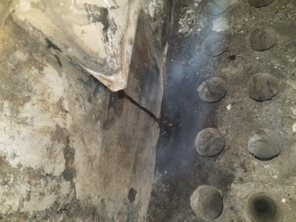

    This weekend I had planned to do a thorough cleaning of my g400 and discovered a water jacket leak that would make alot of the flyash turn to mud
    Contacted a dealer ( not where purchase was made) and he mentioned it to the local dealer to get something figured out with heatmaster
    Hope to hear something tomorrow on repairs
    I'll let you all know what comes of it

  6. lukem
    12,322
    66,992
    Where was the leak located?

    Leak is just above the flues right at the corner of the smoke bypass door 20200208_113559.jpg

    I was having some issues this burn season, felt like air flow through the boiler was off, sounded different
    I added water at initial fire up not thinking anything about it, but every week or two adding about a 5gal pail full
    Now it seems like 2 5gal pails a week or so
    At first i thought it would be a leak in my shop floor but couldn't find anything, was then thinking my underground lines. My thoughts were that much water should show itself
    Fast forward to Saturday, getting ready to rip everything apart to clean all passages and discovered muddy ash buildup on top
    Talked to the local dealer today as he's been in touch with heatmaster, says i need to phone the general manager there tomorrow

    This morning I talked to heatmaster, looks like in the next while they are going to send a mobile welder out to my place to repair the leak, I'm happy with that.
    Must say that customer service is top notch!

    Figured I'd update my boiler issues i was dealing with in spring
    Sent the g400 to heatmaster where they welded up the problem areas, pressure checked everything
    They even did an upgrade to the front to allow a cleanout of the front air passage, no charge!!
    General manager even took me for a bit of a tour of their new shop, clean, clean, clean!!!
