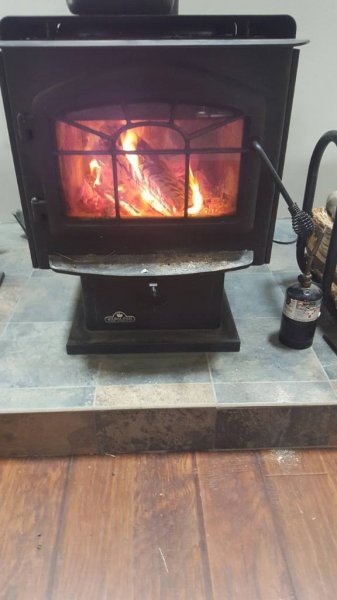

    Oh yeah, I gotcha. I was thinking you said something else. With a small fire, stove top is 434 degrees.

    That stove can handle sustained STT of 600. To get the most out of it you might need to ruin it a bit harder. Also, are you ruining the fans on the stove?

    When I get it going good, it does run about 600. yes, fan is always on.

    You might get the downstairs warmer by leaving the fans off or REALLY low and try to take advantage of the radiant heat instead of convective heat.

    So, house is warming up very nicely. Since I turned the stove fan off, as mentioned earlier, stove top temp went to 508 keeping the same size fire as the picture I posted earlier. And that was with no whole wood left, just coals. I just threw a piece of red oak in and I'll check the temp again once it's going.
