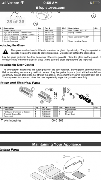

    That’s what I wonder about too but I’ll be able to ask that question when I get it installed and likely see the whole thing. Here’s a picture of the blower diagram for parts. 3B14CA7B-1D84-491E-BD8D-DB4EA40BAD29.png

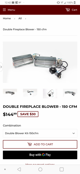

    Hmm, so 2 smaller blowers, vs one larger one like mine, and like most have.
    I'm sure there's other smaller blowers on the sure I linked to. Find out where the blowers go, it's literally a " if it fits in there it will work" thing.

    I’m fine with jerry rigging if it’s internal, at least it can be doable. More than anything I’m worried about a shorting out due to incorrect wiring or components melting due to heat but I’m guessing that this encapsulated area is a good buffer area. Best I wait to see how the face comes on and off and look at it altogether.
  5. Horkn
    29,268
    167,123
    It's not really Jerry rigging. Not the kits like I linked. But I get your point. These kits are really just like the factory ones. I tried looking online for pictures of you stove's fan/ setup. But there's nothing I see. Looks like lopi put a nice wire grommet to run the wiring through.

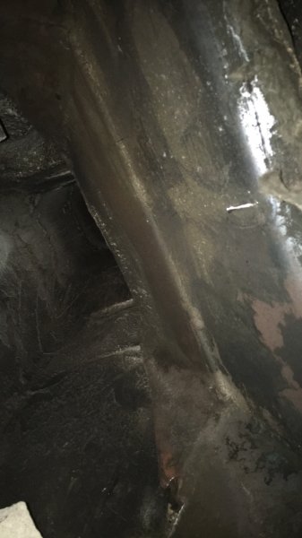

    FatBoy85 I installed a small cast iron stove in a masonry fireplace with no block off plate, only some insulation last year. When I did my cleaning and inspection of the chimney liner earlier this season I noticed that my top plate seal has blown out on one side. I’m assuming this is from the extreme heat that builds up in the chimney because of no block off plate.

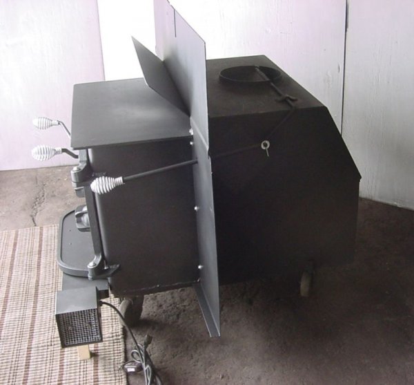

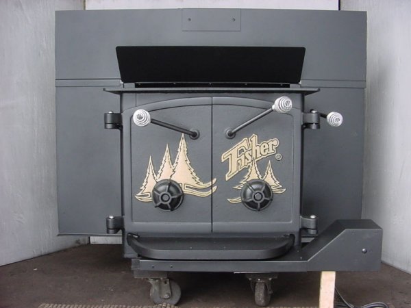

    Diverter / Deflector can be made of any flat plate, sheet metal, coil stock...... to divert rising heat as shown below;
    Insert Deflector.jpg This was supplied with Fisher Inserts.
    Insert hand painted doors w blower 3.jpg Installed as shown.
    Insert hand painted doors w blower.jpg The deflector sits on top of the outer shell and is bolted in place with machine screws you can see in the outlet slot.
    The Insert shown has external blower that was made in many varieties and blows into a slot under firebox, up the back, over the firebox exiting through slot below deflector. The most heat was extracted from the exhaust vent area where the Flue Vent was exposed between firebox and outer shell. Newer EPA stoves will have hotter firebox temps than the actual exhaust pipe, so flow around firebox is needed to extract heat.

  12. tim117
    tim117
    Feb 21, 2019
    98
    469
    Mount Laurel, South New Jersey
    Next time I’m on the roof I’ll take a pic

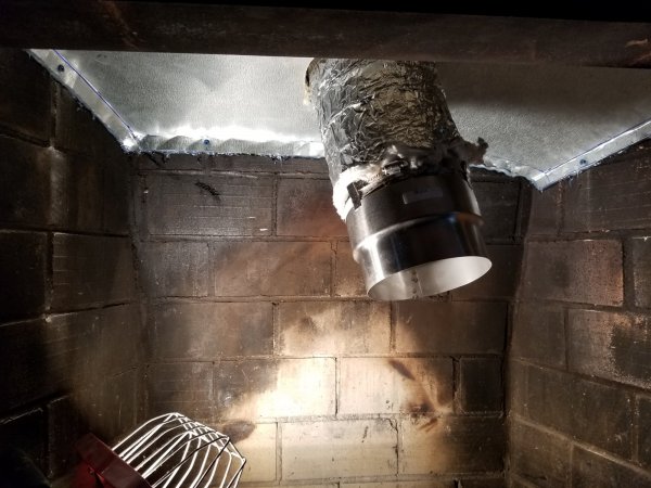

    Not to be repetitive or beat a :deadhorse:but I really think a blower in an insert is a must. I cannot fully heat my home without it. Only in shoulder season or to take the chill out of the house will I ever turn it fully off. Even then I usually put on low just to keep the air moving out and away from mantle/TV. Full disclosure in that I've never tried running fans to circulate the air so I am sure that can work. But getting that super hot air blown out and a way from the insert is really key to getting the air circulating and warming the other rooms.
    Also if you have a TV mounted above the insert, having a blower is imperative, otherwise that hot air is potentially going to roast out that TV in time. With the blower on even at a low setting it pushes that hot air out and away from mantle and TV.
    I have a deflector installed on mine & a pic of my block off plate. Above that sheet metal and around the collar is a bunch of roxul stuffed up there as much as I could stuff. 20181122_112231.jpg 20180831_143650.jpg

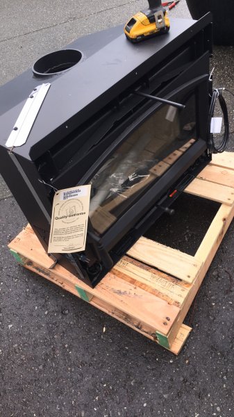

    So the insert was installed without any major issues. They said They were lucky and believe it has a lot to do with supplies and things just by hairs and strings came together. Without my understanding, since I thought the blower was not part of the insert as I thought to have it not on the quote but guess it just happened to be on there. Otherwise it’s better that the blowers were installed as other options would likely not have been sufficient in heating. Also I asked if they were going to put in a block off plate. They did but they did it at the Top Of the chimney. Great. I should have told them that it’s still going up the chimney, heating that and then coming back down. What I won’t argue with is how comfortable the house is. It isn’t hot but right at the middle at 65 is comfortable enough. Heats the upstairs well enough and I feel the heat as it travels upstairs. The moisture/damp cold has been fixed and hopefully there will be another cold snap to justify this as rifht now its hanging close to 40’s and 50’s. C4A5CB4C-3647-4918-8C19-35181A483C0C.jpeg 6356EBB0-5B46-4795-94CF-089206397FE2.jpeg 9B37C837-5041-474B-A5FB-0F824326CE18.jpeg 7E79328F-203E-4E33-B750-FCE8CC0D3C78.jpeg
