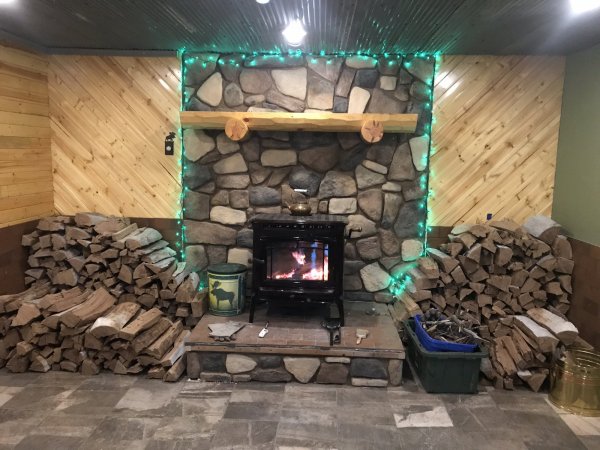

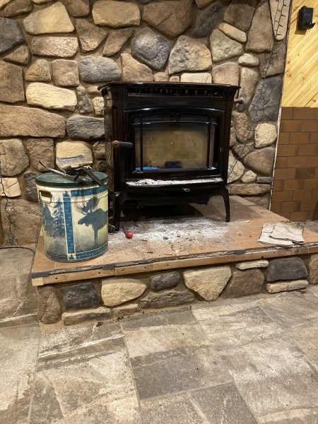

    • Old Nate
    • I have one, had it installed in 2015 in the basement of my ranch style home. I wasn’t a member here at the time and knew very little about wood stoves. Was remodeling the basement ( water damage and mold when we bought it) took out the open fireplace and put in the Manchester. I settled on it based almost completely on the looks and appearance. ( gloss brown to match a gun safe that ultimately ended up in a different room)
    I bought the blower kit with it. It takes right at 45 minutes from a cold start until the fan kicks on. The stove does probably 90% of our heating, only run the electric baseboard heat in the master bedroom because it is difficult to get the warm air back there.
    It has always burned hotter and more completely on the right hand side which has the side load door. (Which I hardly ever use anymore) I thought maybe the gasket on the side door was leaking so I replaced it, but it didn’t change anything. Now I think it’s probably getting extra air through the ash grate at the bottom, maybe the clean out door gasket? Don’t use that either, just scoop ashes out through the front door.
    After 6 seasons I’ve just learned to live with it.
    So… after 6 years and knowing what I know now as opposed to when I got it, would I get the same one again? I would probably look into something a little bigger. It keeps us plenty warm even on the coldest stretches, but I have to keep vigilant about tending the stove.
    I love the look of it and all visitors comment on how nice it looks.
    Overall I’m pretty satisfied with it.
