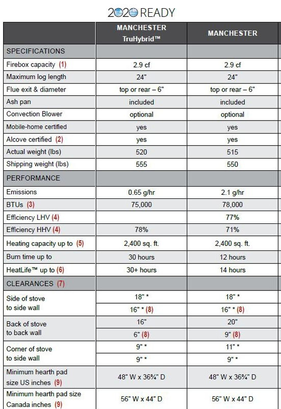

    So Rich, how are they doing this? More than double the burn time?
    I'm looking at the ManCHESTER, not Mansfield, but the old Manchester lists a 14 hour burn time, the new "Manchester TruHybrid™ 20/20 Certified" (and they're the same size), lists a 30 hour burn time. I'm with you - this is a huge deal, if it isn't just a gimmick. Maybe you or someone will have insights on my question.
    Yes, these are stated as BURN TIMES, not "Heatlife™" (both) are listed on page 62 of the main Hearthstone Stoves product catalog.

    I think they're attributing these long burns times like everybody else to the catalytic converters.Isn't the manchester smaller than the Mansfield.If so and it doesn't have a Cat.forget 14 hr burn times My One doesn't burn for 14 hrs but with the burn time and the heat off the stone I'm getting 14 hrs of good heat.Of course the pipe damper also helps.On the new line of stoves someone else will have to bring the insights.I won't by one until I hear some real time experiences.Even then I may stay where I am.

    Partial of page 62 of the main Hearthstone Stoves product catalog.

    A 200 degree stove after 19 hours. Not terrible for 2.0 cubic feet but 200 is not what most folks consider burning and the fire has certainly gone out. I wonder how long the cat was active which means burning which happens at exhaust temps of 500 and up.
    Hearthstone used to have cats. They are not totally new to this.

    I agree with Highbeam
    1. 200* is not heating much
    2. CATs stop throwing heat at 500*. When new and with dry wood
    I just went and checked my IS is still 138* from fire loaded Wednesday night it’s Friday. Is it heating now. I would say no. Could I re light without a match yes. Loaded with mostly red maple.
    Would I claim this as a 43 hour burn time?
    I wouldn’t

    That old Manchester is smaller than the Mansfield.The burn time they quoted is so inflated.The bigger Mansfield won't give you a 12 hr.burn time even on it's best day and I doubt the Manchester will either.Since these guys inflate the burn times nothing they state can be trusted.

    Yea they list the Clydesdale at 12 hours and I pack it to the gills and am always below 200 degrees after 7 hours.

    We do know that there are lots of different definitions of burn time. Manufacturers usually use the most liberal one to pump their product. Okay. What we should be able to assume is that whatever the old Manchester could do for burn time, the new Manchester can go twice as long.
    There’s no free lunch. If your home needs 5 cubic feet of fuel per day to stay warm then you’re still reloading twice per day. That’s okay though because you can set the stove to burn constantly for 12 hours vs. a big surge of heat for three hours and then a long 9 hour cooling period. Way more comfort with a constant heat in my experience.
