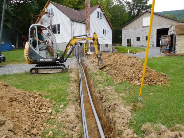

    here's a construction pic from over the summer
    I was putting my services under ground so i could finish the roof
    you can see the flue is out in the middle of nowhere. wish it was at the peak for better support
