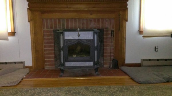

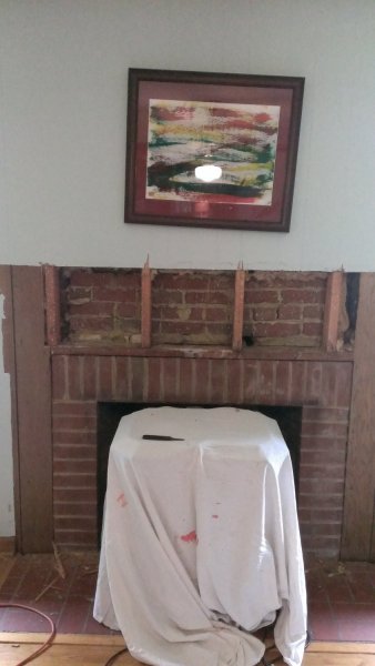

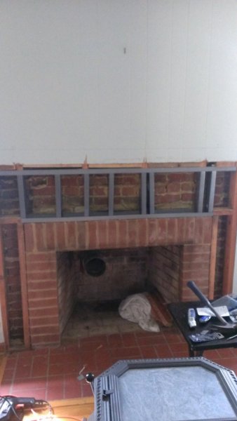

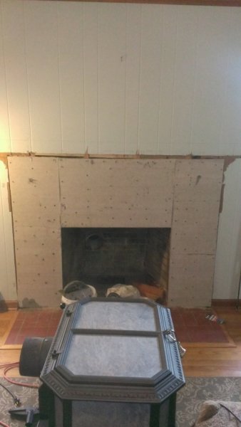

    So I started this project a couple weeks ago and posted in a couple differant forums but Im finishing it here. Heres the final for now results of my rebuild. This was done in order to meet the clearances to combustibles that are required for a Fireview stove. I took down the original mantle and surround, rebuilt the wall just above the stove in metal studs, then put hardibacker 500 cement board up tiled grouted and wa-la I now meet and exceed all the ctc that are required for the FV. I had to put a thermal protection hearth pad down under the stove as Im not sure what is under that tile floor. Next year I will rip that up and tile it all back in and hopefully this year i will be able to afford the mantle that I have picked out but right now thats the least of my concerns. Now if only it would get cold and I can use this thing the weather man says it will be near 90* tomorrow:mad:
