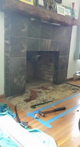

    What is below the hearth?
    self leveling compound and then durock in layers should get you by, provided the supporting structure underneath is solid block

    There's at least two layers of brick then cinder blocks under that below the house my main concern with the leveler is that it will run into all the holes in the bricks and through in between them. They are just stacked there no morter on them I could pull them all out if I want to which I dont.

    How about chisel any loose mortar off the old bricks, put down some mortar to fill the holes and put durock down while wet. Tapcon screws put in once set up.

    mix a bag of pro-grade grout to a stiff thickness and fill the brick holes with a v-nose trowel

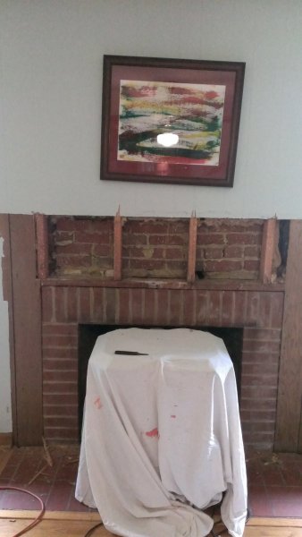

    Here is a series of pictures from start to finish. It only took a little over two years.
    In the beginning
    Started the demo of wall found wood studs
    Replaced them with metal studs and removed everything that was combustible within the clearances to combustibles for the stove
    Durock cement board went over the brick
    Found several layers of brick underneath
    I used cement to level the brick area to the plywood sub floor then laid down durock and sheet metal.
    I painted the brick inside the fireplace and finished the trim yesterday. Now I just need some more muscles to help me put the stove back in place.
