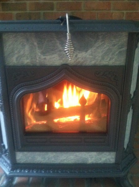

    Of course I couldn't resist ...
    Had the first kindling fire Friday evening when it was 68.
    Had a little bit larger fire this morning when it was 50.
    Here is the current fire at 49.
    Maina, Woody Stover, Brad38 and 7 others like this.

    That didn't take long. Just the way we like it, with pics.

    Having fun with the new stove. Had the first extended cat burn today. Here are my observations so far:
    1. Stove is quiet compared to my old one. Old one would ping and pop until up to temp (entire back was cast iron and a bunch of internal stainless used in cat chamber area). The only noise this makes is when the cat is engaged and you here a metallic tic tic tic sound for a few seconds as the cat lights off.
    2. Air control on new stove actually allows for controlling the rate of burn. Old stove had three air intakes: primary, slide air wash, bimetallic catalyst air. Air wash was so crude it probably let in as much air as the primary. The bimetallic air worked like an inverse thermometer letting in more air as the cat chamber got hotter - had no control over it at all. Very nice to be able to change the air settings to see more flame or take the box black. I've always heard of this capability, but was pretty cool doing it for the first time.
    3. Old stove would leak smoke when adding wood; new stove does not. You can actually feel the air being pulled into the stove as you load wood - the rear draft of this stove is obviously designed much better.
    4. Cat lights much quicker than old stove - I engaged less than 30 minutes from cold start (stove top temp was 200). Manual suggests 250 stove top to engage, but this seems like a conservative number and I have heard others speak of engaging before 250.
    Very glad we got a bit of cool weather so I could get the stove seasoned and get a few trial runs in prior to next fall.
