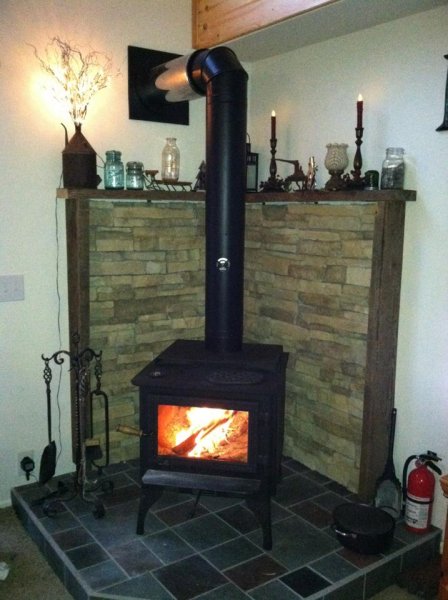

    My upstairs stove.

    Nice setup on the upstairs stove there, Buckthorn.

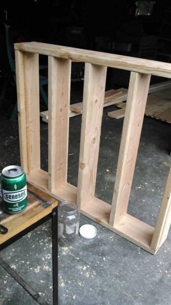

    Part one done. Frame for the main hearth pad is done. It's 48x42, framed with 2x8, 11" on center, 3 /4" plywood on top, which will get two sheets of durock, mortar, and slate tile for a finished height of 9 3/4". It was nice to have help. ;)
    -edit- Those are Mrs Papi's pink toes in the shot. I don't work in flip flops.

  18. Chaz

  19. Eric VW
    24,576
    141,811
    Do you own a pair of slippahs?
    bobdog2o02 livs seeing pics of men’s slippahs....:whistle:
  20. BuckthornBonnie
    BuckthornBonnie
    997
    3,318
    Penn Yan, NY
    Nice platform and Genny.
