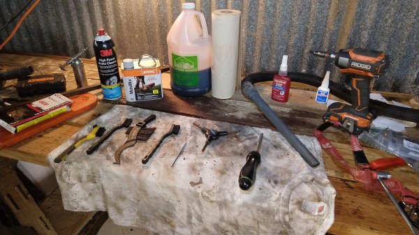

    And the healing bench/repair therapy center awaits...
    There is another victim to be looked at. She's a long term patient that I don't really want to talk about... Lolz!

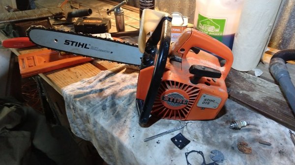

    I've bested him. This one was $Free.99
    Step one: we admitted we had a problem...
    Yeah, I'm more of a "corpse flower" guy. This saw looked great, but...
    I had high hopes. Someone bought a new bar, chain, sprocket, for it. Then, as the story goes, left it sitting for years with bad gas in it...
    I've had the carb off and apart a few times. Bought and wasted a couple of rebuild kits and my time...
    I'm going to say this in hopes of being proven very wrong, and shown the way. Ready?
    STUPID WALBORO 015 CARBS ARE IMPOSSIBLE TO REBUILD. THEY'RE OBSOLETE AND NO ONE HAS A REPLACEMENT!
    There. I said it on the interwebs. *Someone* will come along and prove me wrong (I hope).

    You beat him on price , If it was free.
    He did drive about 3 hours for an old home-lite and the guy had this one as well. With fuel cost and his other half going with him he paid the price. :eek: Saw $ 10 ; all other expenses = priceless.
    Admitting a problem ; he says he doesn't have a problem.
    Except walking through his garage around everything piled up. ( It's bad !!!! )
    Can you take the carb apart and soak it in something like acetone and an ultrasonic cleaner ? Just a thought??

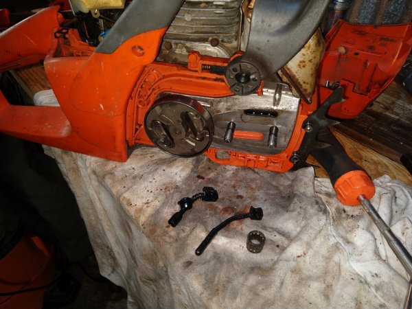

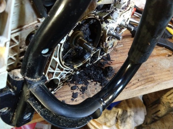

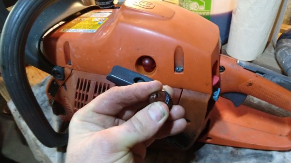

    CLEAN YOUR SAWS EVERY YEAR!!!
    Take them apart, covers off, down to the case and tanks, and blow/vacuum/brush out all the dust and oil packed in behind the clutch and chain brake.
    I thought I'd get through the season since superficially, this one didn't look "too bad". Then I remembered it was the one the guy I got it from said he had a "faller-buddy look at it" when asked about service.... So, it needed more cleaning than I'd done already.
    The drive pin for the oiler might not have been in the notch. It wasn't oiling right at all. I probably used two cans of brake-cleaner, and brushed for 30 minutes to get it clean.
    It went back together beautifully, and seems to be puking oil in all the right places now...
