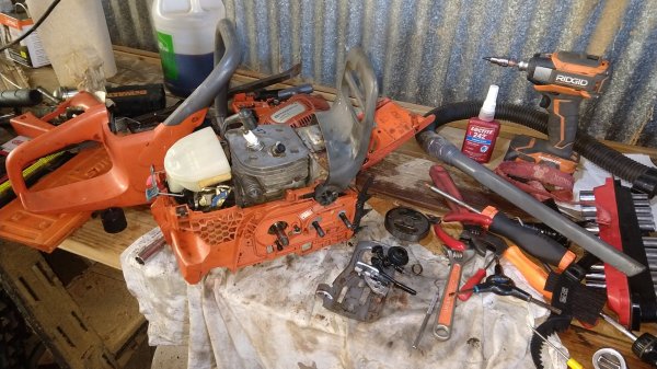

    IMG_20200319_162433560.jpg Anyone else enjoy taking things apart, with little hope of ever getting them back together, let alone running again? Well, grab your BIGGEST tool and let's get to it!!! J/K...
    This was the first saw I bought. It was used, and I immediately tore it down and cleaned it early last year. It had a new plug and filter, and ran great.
    Shortly into the season, a common problem (just a nuisance really) reared it's head. The oil line from the tank became an "automatic drain". So I kept it full, and never set it down right side up anywhere I didn't want it to piddle bar oil...
    So, deeper we go. Like an onion; peeling back the layers until there's nothing left but tears and regret...
    It'll get both the in and out oil tubes. They're more like hard plastic than rubber at this point. Oh, and a new bearing behind the clutch.
    It can be a cathartic. I was listening to Bach, and huffing two-cycle exhaust from tuning the MS 391.
    I'm anxious to hear your DIY stories. Especially if they run again afterwards.
    P.S. I do have another project that might never leave the healing bench I'll share sometime. Walboro carbs be dammed!

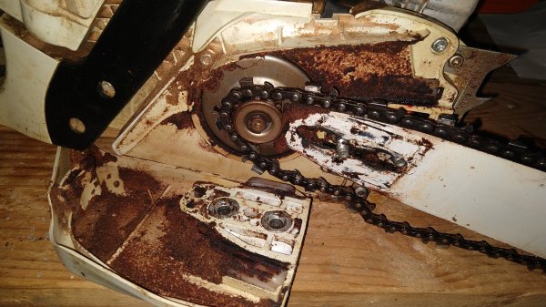

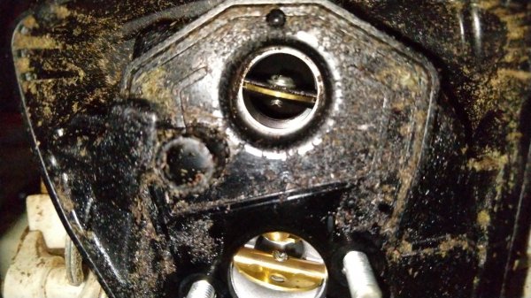

    On a brand new saw (or anything), I agree. But buying used, I'm going to verify its "barely broken in" status myself. For instance, my 391 came to me from a guy known to buy food gear, and take care of it. I asked him when the last it was serviced. He said "it's never needed anything, or let him down", but he had a faller buddy of his look at it every couple of years....
    This is what I found: IMG_20200120_113733664.jpg
    The air filter wasn't clipped on properly, and there was sawdust in the intake. IMG_20200120_112531817.jpg this isn't a lot of use, but I can assure you,i hadn't been "cleaned" by his buddy...
