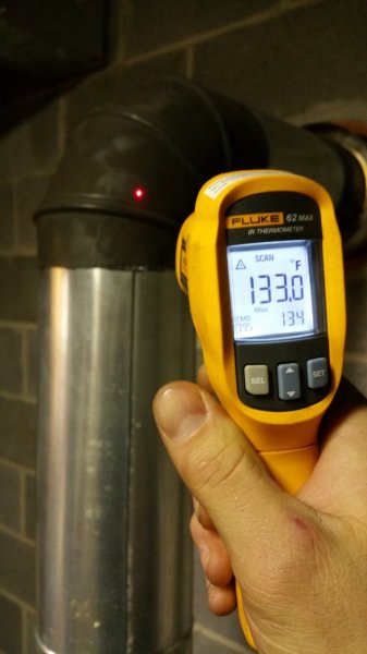

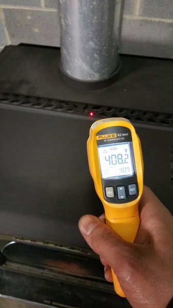

    These temp pics were taken around 1130 pm (as soon as I got home from work)....approx 1" of coals left in the firebox after filling it up before I left for work at 1030am......currently trying to get a bigger base of coals as I just filled firebox up with oak split into 1" x 2" pieces and air intake fully opened

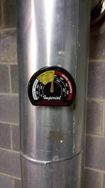

    For now I picked up a moisture meter and a magnetic flue thermometer....the majority of my wood is between 9% and 18% (hopefully this is ok) and my flue temp is not quite 500°....so it looks to be good for now. ..fingers crossed 14206987974721512151045.jpg

    UPDATE........my TL300 is working fine. ...I've been burning really hot in fact the magnetic burn indicator on the pipe is reading in the red (over fire) Around 600°...this is the only way I can get the secondary to light and stay lit, burn, and put off heat....all of my wood is between 8% & 19% moisture. ..which I'm thinking is decent.....still going to unload it come spring and look for a coal/wood stove

    Are you sure the thermometer is readind true?
