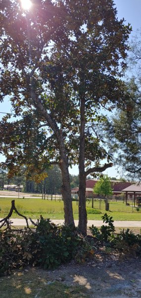

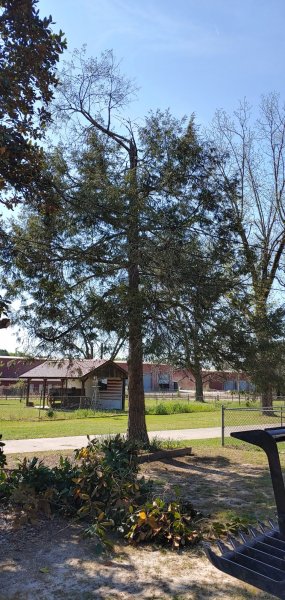

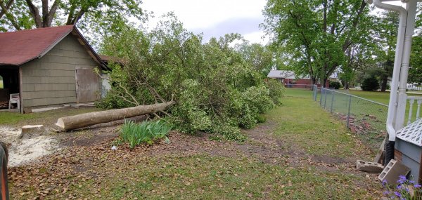

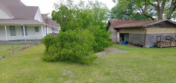

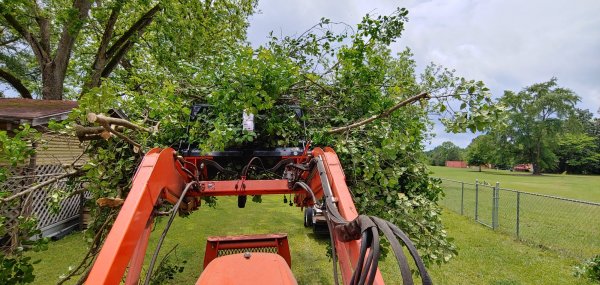

    That grapple sure made it nice with all those prickly leaves... 0505211320_HDR.jpg 0413211248_HDR.jpg

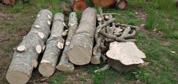

    Got a nice amount of logs. Don't know how the magnolia and hemlock will be for wood. Hope the holly is as good as the chart says, better than red oak and dries faster. 0413211401_HDR.jpg

    Thanks buddy. That leaner had me a little nervous, wasn't sure how good the hinge wood was gonna hold. I put the grapple against it with a bit of pressure, cut my face notch clean, started on the felling cut, set hinge on leaning side, worked my way back, tapped in a wedge, finished cut, leaving hinge thicker on the off side, drove in 2nd wedge. Got on tractor and gave it a slight nudge. Sure didn't want to fix a fence...got over 30' of logs off that tree.

    It's supposed to be the same BTU as beech. The last time I burned any it was in a fireplace. They're no fun to have in the yard when you have kids running around barefoot.

    My dad has one, the wood is pretty soft as far as branches go. I can't say it's much different than walnut? That Holly though...I've got a bunch of rounds not split yet. That'll happen this summer.
