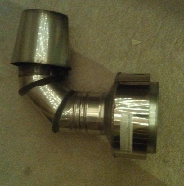

    You need the Selkirk DT 45 so the system will work as intended. I used a 45 on a customers job. She had a farmer's porch so I ran the DT under the ceiling but sloped it up and then a 45 facing down at the end. It worked out very well.
  2. smoke show
    smoke show
    2,983
    13,948
    Pittsfield, Wi
    On my basement install I used a 90 and removed the inner pipe from it and attached the termination cap to that. I'll try to get pics here shortly.

    I already have enough DT to make it work as intended.
    Thanks Smoke. That's exactly what I was thinking I could do. Regular Selkirk hooks to the end of the DT and gets the termination farther away from the intake and allows me to get a bend, so I don't have wind blowing straight in. :thumbs: Thanks bud

    Just to clarify that's the inner from a piece of DT.

    Then why not use the DT?
  8. DexterDay
    DexterDay Administrator
    12,411
    31,637
    Northeast Oh
    Because it's expensive :)

    But if that piece came from a DT then why not use the piece of DT that it came from? Is it more work to take it out?

    I know I seen another pic where someone used a regular piece of Selkirk venting and attached it to the end of the DT kit (other than Smokes).
    The way the end looks, it should take a piece of vent?
    And I wouldn't remove the inner piece of DT. Just trying to avoid another bulky piece on the end. That's why I just want a simple piece of 4" vent

    :rofl: :lol: i had the extra 90 on hand and I agree it looks a lot less bulky.

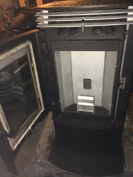

    Here is another cleaning video of a Enviro Mini with a blast of 150 psi air
    Pic 1 - Before Cleaning - Ash Pan was full of ash!
    Pic 2 - After cleaning - Looks better than new! LOL
