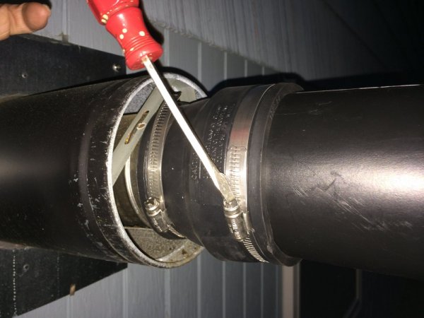

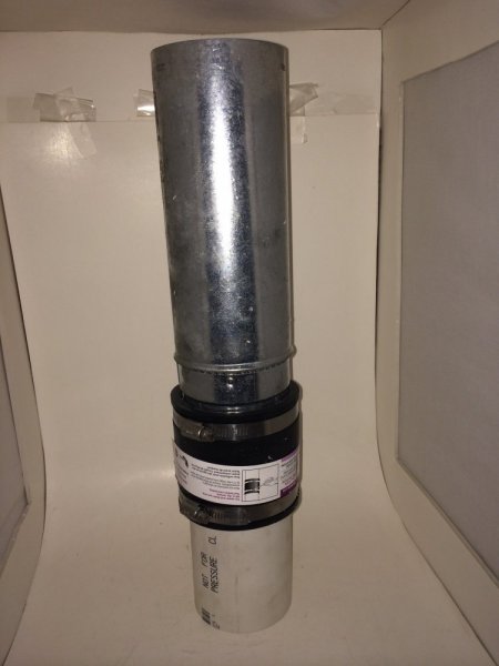

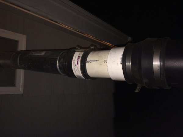

    Hear is my During Picture!
    Using my new 4" Pellet Pipe or Selkirk DT to Leaf Blower Adapter!
    This is the way we clean out pellet stove early in the evening! See Leaf Blower Video!
    Also see pics below!

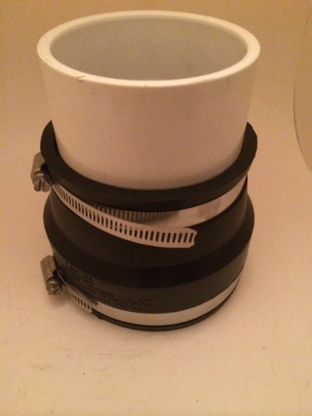

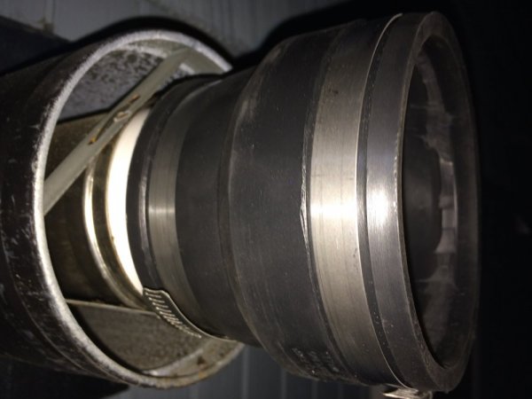

    Hello
    The adapter I made in the previous post is great for 4" Pellet Pipe and DT Pipe because it just slides right in and is a snug fit! ! !
    To do my shed stove that has 3" pellet pipe, I built a reducer with a 3" Adjustable 12" long pellet pipe.
    The reducer has 4" PVC that slides on the adapter above and after you remove the 3" Termination cap, it slides on the 3" pipe so you can blast away! ! !
    See pics below, click to Enlarge!

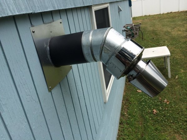

    What size straight pipe did you use to go thru the outside wall? I used a 2 footer and then put a 45 Deg to keep the smoke from blowing in the windows on a real windy day.

    I like the 45° idea Don. I used a 2 footer as well (Bought it from you ;)) In a severe storm last Winter, the stove went into shut down mode, because the air blowing straight into the pupe, was enough to trip the vacuum.
    Do I have to use DT for the 45°. I thought I read that regular Selkirk will connect onto the end piece that the cone (termination cap) hooks to?
