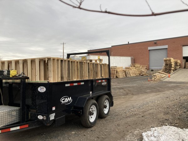

    New idea. Instead of dumping the splits on a truck how about if I could dump them in a crib made of pallets? Thinking four feet wide and six feet tall. Build as you go and just move the splitter back as it fills. Less wood per volume but who cares. No stacking.
    Grabbed a load of six foot pallets today. I will give it a go after the box wedge, castor wheels on splitter and trough is designed. Just a matter of designing a fast system to put it together as you go. Easy enough.
