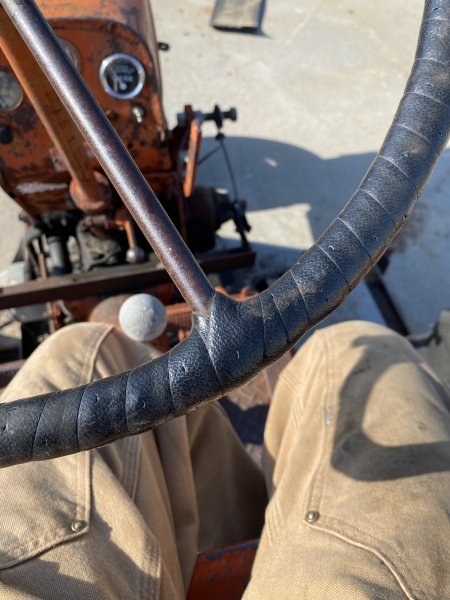

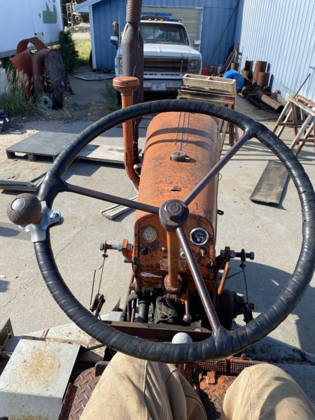

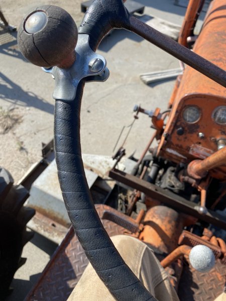

    I don’t know if you can still find it, ( maybe on the web or eBay) but the stuff that they used to wrap handle bars on ten speed bikes works pretty well and looks decent. I did it on my old VAC Case that had the same issue. This has been on it for probably better than 10 years

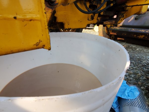

    Just got back from a trip to GA. Drained hydraulic oil this evening. There was a titch of water in it. 20210714_191035.jpg
    I'm guessing Tractor Data .com was wrong on 24 gallons. 24 quarts (6 gallons) seems to function just fine and matches the quantity drained.

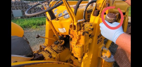

    My hunch is water found its way into the tank through the filler/vent. There is a machine screw with a metal washer holding the vent cap on. I removed the tin cap, used a ballpeen hammer to "dome" the cap. Then, grabbed a rubber washer from the metal roofing screw. Voila! Hopefully, that takes care of it. Screenshot_20210714-205300_Gallery.jpg

    Soooo..... on another topic. What's mounted on the back of the old GM square body in the pic?
    Hockey stick tape works good on the steering wheel too.

    It’s got a maintainer service body on it. Small hyd boom hoist, torch, air compressor. The whole rig was ALMOST handy when it was running. Hasn’t run for probably 5-6 years. 1ton dually, reverse manual valve body 400 transmission…and 6 cylinder Isuzu Diesel engine.

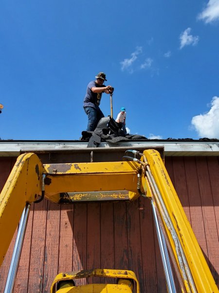

    First real job for the Massey. Stripping shingles, well hauling stripped shingles. 20210725_153512.jpg 20210725_153518.jpg
