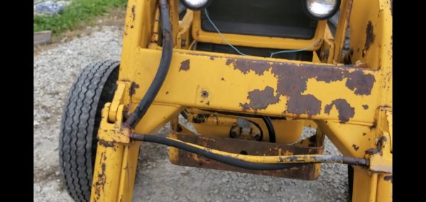

    The rear end has nice and clean oil. This, an industrial model, has a separate reservoir of 24 gallons of hydraulic oil. It appears to be integrated into the loader frame on the right side. It doesn't look like it could hold 24 gallons, but I guess with cylinders, pumps and all the lines it might hit that high.? The seals on the valve body for the loader seems to be as good as new. Maybe the vent cap is the culprit?

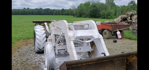

    What did you put all over the tractor?
  10. brenndatomu
    25,368
    165,311
    The deal was just so sweet...

  11. Gasifier
    20,507
    104,134
    Degreaser?
  12. brenndatomu
    25,368
    165,311
    My guess, yeah...its one of those "foamer" guns you can put on the hose...
    Amazon.com
    MikeInMa, Gasifier, JimBear and 2 others like this.
  13. Casper
    Casper
    Jan 25, 2017
    1,710
    9,667
    Yep, mine goes on the end of my pressure washer. Foam cannon.

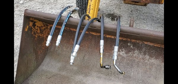

    Finally made it to a different hydraulic shop recommended, first by the owner of Euclid Hydraulics, since he was busy last week with getting a crane repaired and then this week, he is solo in the shop. Secondly, by my cousin whom I saw over the weekend who is an Excavator.
    Diversified Fittings in Perry. Super fast, fairly priced and refitted the wonky fittings that go into the valve body and replaced the rubber.

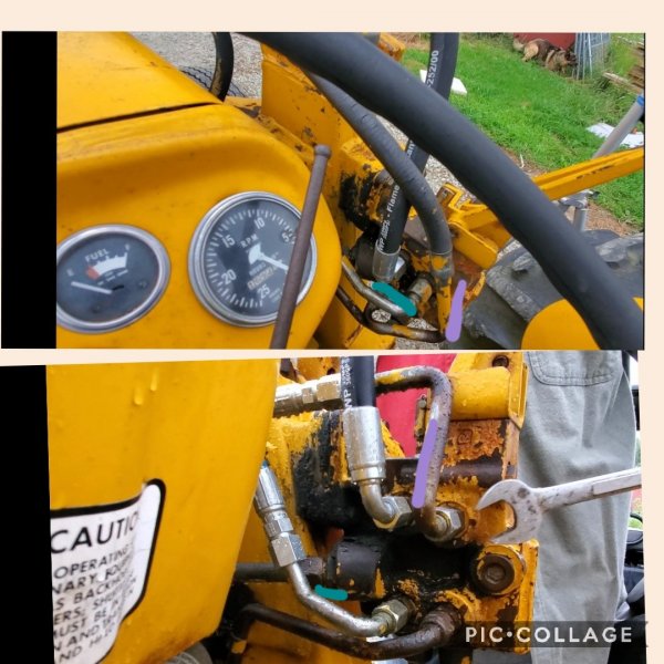

    Had to make a slight mod in hose routing. The compression fitting, when the hose is routed the original way, interfered with the valve body lever mounts. I was able to swap them and change the connection at the other end. Lower pic is the modded version. Teal colored line swapped with purple in factory setup in upper pic. It is clean looking and doesn't seem to cause problems so I'm happy with it.
    Interference when setup factory way:

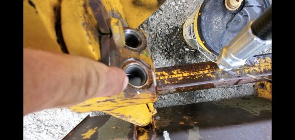

    Hydraulic filter comes in tomorrow, I used about 3 gallons of the milky hydraulic oil to purge the lines. On one cylinder I needed to use a cut off wheel and cut a couple fittings so I could use a 6 point socket to remove them. They were in there pretty tight. You can sort of see the dirt in the "top" port compared to a cleaner lower (in pic) port. Threads are were you can see the dirt/debris. Screenshot_20210707-215524_Gallery.jpg
    Offending hoses and fittings:
    I'm thinking this system must only hold 24 quarts, or 6 gallons. It was pretty jittery when raising lift beyond half way. Oil gets changed tomorrow.
    Gasifier, MikeInMa, SimonHS and 6 others like this.

    That's it.
    I wish I bookmarked the site saying 24 quarts. I saw it when I was debating getting the tractor. Now, I can't find it. Six gallons of hydraulic oil seems more inline with capacity by looking at the space available. Also, I have a difficult time believing 3 gallon out of a 24 gallon system would cause the jittery movement above the half way point. Half the oil in the system?...that makes more sense to me, especially with older equipment. I know there was some spillage, but most oil went into the waste oil bucket I used to purge the lines so there is a fairly accurate measurement.
    I guess we'll know in a few hours when the filter comes in to NAPA.
