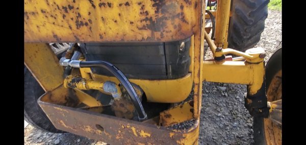

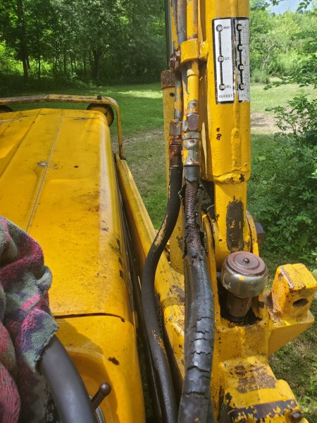

    Pump (worst case) is around $400, could be as simple as a roller ($10). Power steering pump is $200. Not sure on lines, much of the system is steel and that is all fine. Rubber has three off the loader valve to steel lines along lift arm, six at the front for dumping/curling and return lines on lift. The latter two had been replaced when he had lift cylinders rebuilt, so I'd need to replace the remaining 4. Then there are two larger hoses off the main pump in front. I'm guessing $500-600 in hoses/fittings. I'd probably rebuild the curling cylinders while I'm at it since they can't be far behind the lifts.

    It runs!
    I tempted fate and the curl line blew.
    At local service place now, hopefully they can dig up what they need. Rest of the lines will go to Euclid Hydraulics.

    Runs is good!
    Rubber Hydro lines need replacement anyway

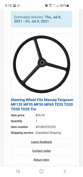

    It tracks better than my 2012 Kubota, although a suspension seat is going on this baby! If the three point is as simple of a fix as the power steering and startup, there would be a bit extra in the budget and I might look at something better than what I was originally thinking about.
    The steering wheel has oxidized and is degrading to the point that it looks like you played in a bag of charcoal when you're done driving this thing. I was thinking of trying Plasti-dip to seal that crap in. As anyone use that product in that type of manner?

    Ordered a new steering wheel.

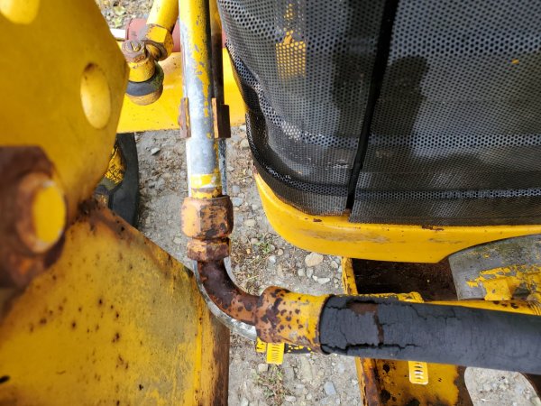

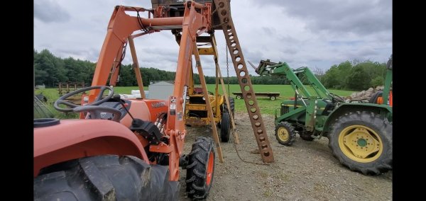

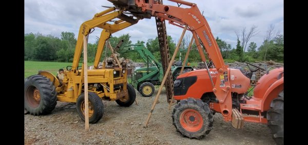

    Can't we all just get along? Tractors of different lineages working together towards a common goal. Changing the main high pressure hose of the main loader/hoe pump. I'd say it has exceeded it's useful life.
    20210701_134417.jpg It's tough for me to get to when the loader is down. Taking the loader off looks like a solid 3-4 hour job for me. Probably just as long to put back on. Decided to do it this way:
    The 2x4s were really only there to "crack" if the loaders started dropping. Then I'd know to get out of there. I used a telecom boom truck segment and chain as a "jack stand". I did end up chaining the front axle on the Kubota and Massey together. They wanted to push away from each other when we tried lowering them. Chained together, there was very little chance of them coming down.
  20. Casper
    Casper
    Jan 25, 2017
    1,710
    9,667
    $115.00 later for one 3/4" hose and fittings.
