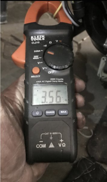

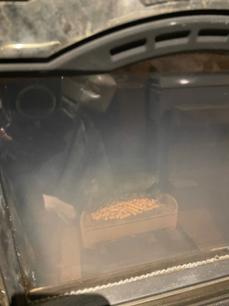

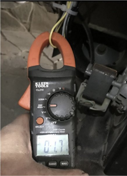

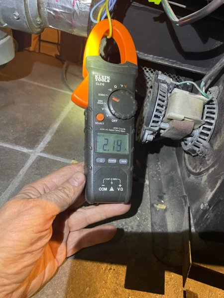

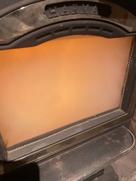

    In many cases delayed ignition can be caused by a very dirty pellet stove or venting so cleaning the stove thoroughly and event blowing it out with an air compressor of leaf blower may resolve the problem. However in this case, A Harman P61 delayed ignition was caused by faulty semiconductor called a Triac that switches the AC to the igniter on circuit board. By placing an Amp Clamp on the yellow wire, it shows the current draw of 2.21 amps. The normal measurement should be approximately 3.5 amps to light the pellets properly. I have also seen a case where the current draw was only 1.7 amps and the pellets would not even light. Replacing the circuit board solved both of these problems.
    See Video
    Harman Pellet Stove Delayed Ignition total solution - YouTube

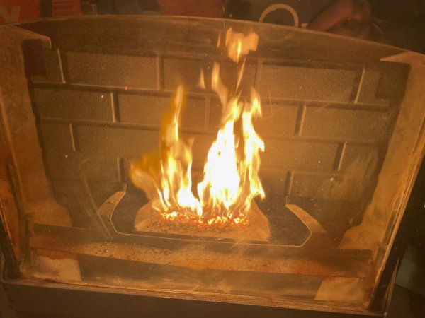

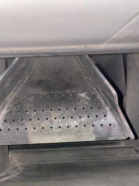

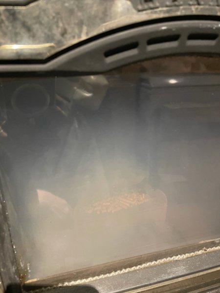

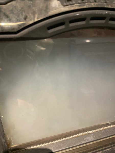

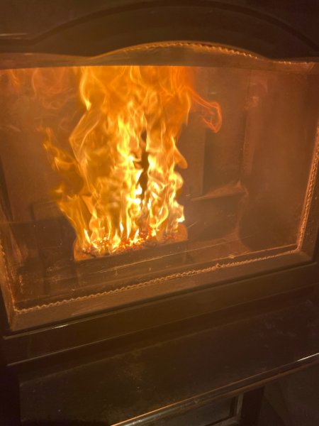

    Pics 1-6 show delayed ignition
    Pic 7 - Limited igniter current draw on yellow wire from bad triac on circuit board causing delayed ignition (Aprox 2.0 amps)
    Pic 8 - Full igniter current draw from good on yellow wire from good circuit board giving normal ignition (Aprox 3.5 amps)
    Pic 9 - Low igniter current draw on yellow wire from bad triac on circuit board causing no ignition. (Aprox 1.7 amps)

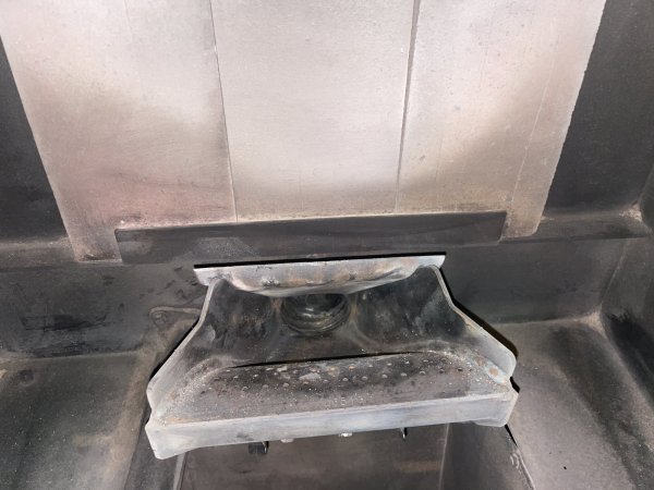

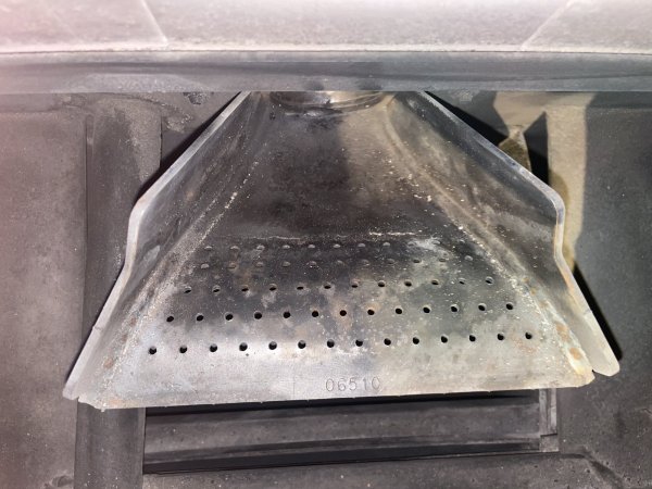

    There is another possibility on your P61. Harman made different burn pots over the years for this model. The latest OEM burnpot works the best!
    I just purchased the latest and greatest P61 burn pot just recently for one of my older P61s I bought used. OEM part # 1-10-05802
    See pics of mine below. It has 5 rows of holes and No Holes in front of the auger tube. One issue they had was holes right in front of the auger tube burned the tip of the auger out prematurely.
    Also if you have the red bank of DIP switches on the back side of your control panel. Check to see if the first 3 are set for the correct auger timing to charge the burnpot with the correct amount of pellets. If they are set for too many pellets and this could also cause the delayed ignition. You could also adjust the timing down to solve the problem if the budget does not allow buying a new burnpot right away. :)
