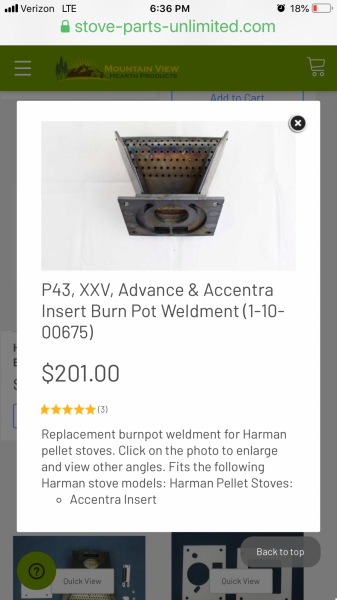

    According to this, the updated Fluted Burn Pot is for all of these stoves.
    It works great on my P61a too!!
    Ssyko and bogieb like this.

    9,947
    Yes,I was just pointing it out,as it is not for the FS,as your other post said.Anyway,there is an up dated pot for the FS.Looks the same as the old pot,except,just ahead of where the flame guide rests,there are 2 raised bumps.HHHMMMM??
